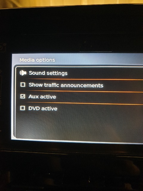

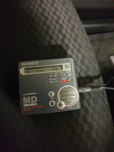

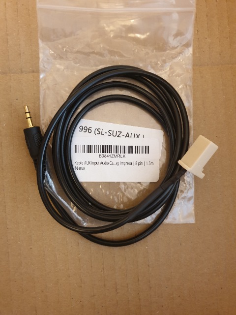

Thanks to someone on the FB group I now have an Aux input on the Gen4. Might as well put my MiniDisc player to use.

Cripes, Mini Disc! I used to have one of those, I'm not sure what I would plug in to an aux connector now. Chris

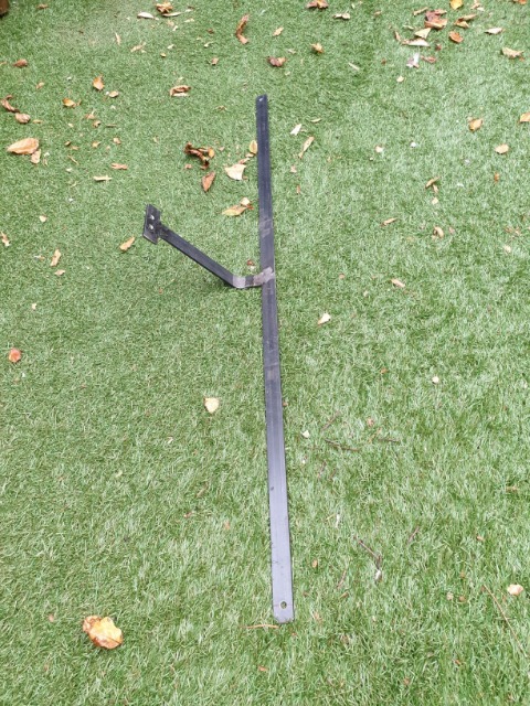

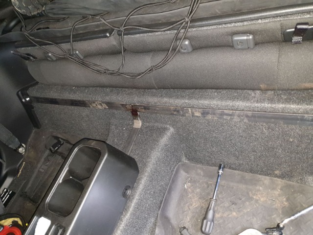

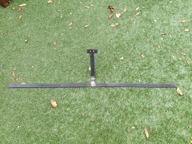

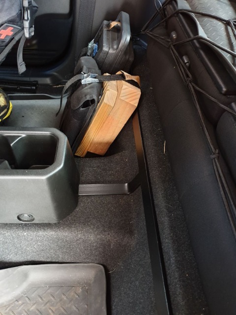

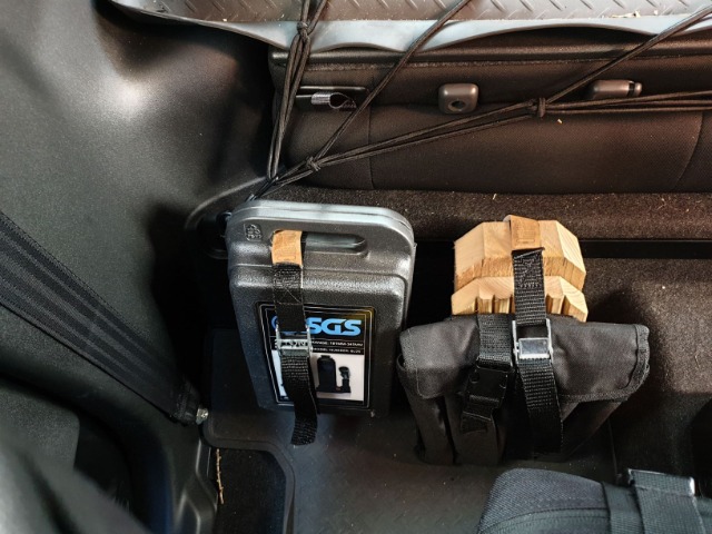

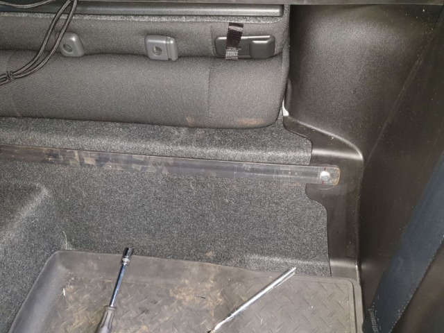

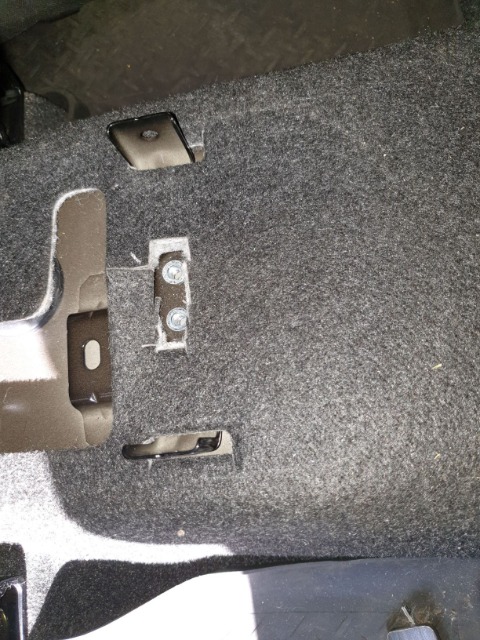

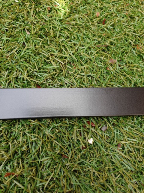

As my kit expands, I need to find secure places to tie them down. Recently bought a bottle jack as I'm sure the supplied scissor jack will be useless off road, not even sure it will cope with the 40mm lift on tarmac. Also some blocks of wood for soft ground.
25mm x 4mm flat bar. I ended up using two pieces welded together in the middle. (2 meter length was too big to get home so bought 2 x 1 meter).
Thought it might give too much if only bolted at the ends, so added a central brace.
Tie down points removed for now, and bolted in place.

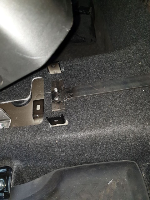

Found a bracket underneath the carpet under the cup holder. It has two holes that are perfect for a couple of M5 rivnuts.

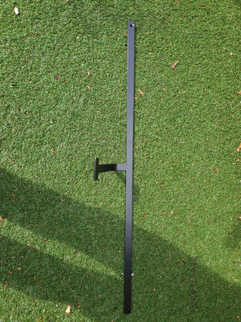

Back from the powder coaters.
Thought that would be better than a painted finish inside the car.

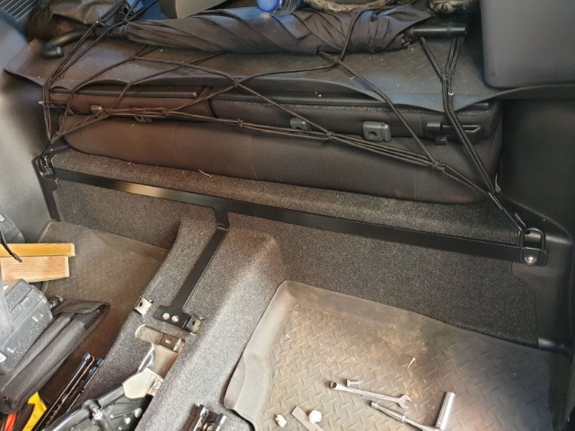

Final fit with tie down points over the top of the flat bar.
2 x M5 bolts in to the random bracket. Just a small notch needed on the bottom edge of the cup holder.
Bottle jack in its case strapped down and folding Zombie shovel with the jack pads next to it. Might get another strap and tie the blocks down separately.
No longer rattling around loose.
