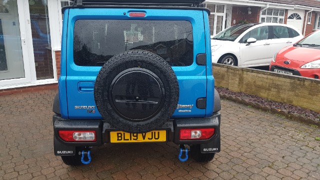

Hya Soeley,
I fitted the jimnyBits rear tow points today. It was a success!
Soooooo now i'll be fitting the front tow pojnts. Can i ask, gow the heck did you find a reference point to start the hole in the bumper?
Bcus the bumper wont fit flush with the points attached, im racking my brains to figure out where i would start. Im wondering from your pictures whether i could gain a good statting point from noting where yours are located.
Any tips my friend??
Thank you kindly Soeley!!
