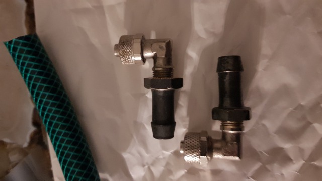

No, seriously I don't mid doing that for you. I did tweak mine slightly after that installation. I swapped the ARB push fitting for 90o elbow type one on the front as it was hitting the chassis a full articulation. I will have a look in my parts bin to see if I still have any of the airline connectors. Let me look (be Friday) when can have a good root around. and I'll get back to you.

Lucky you! I just had two of those specific fittings left. As you can see in the picture, I used one these all metal elbows for the front. For the rear I used a PLASTIC SWIVEL ELBOW . The one on the rear has been fine, but when I used one on the front it snagged on some chassis and broke, hence swapping that one for a metal one.
I'll try and get some decent pictures of it in situ and post them here.
Although the thread is 1/8" BSP, so is slightly tapered, a bit of PTFE tape would't do any harm.
Message me your address and I'll pop them in the post.
