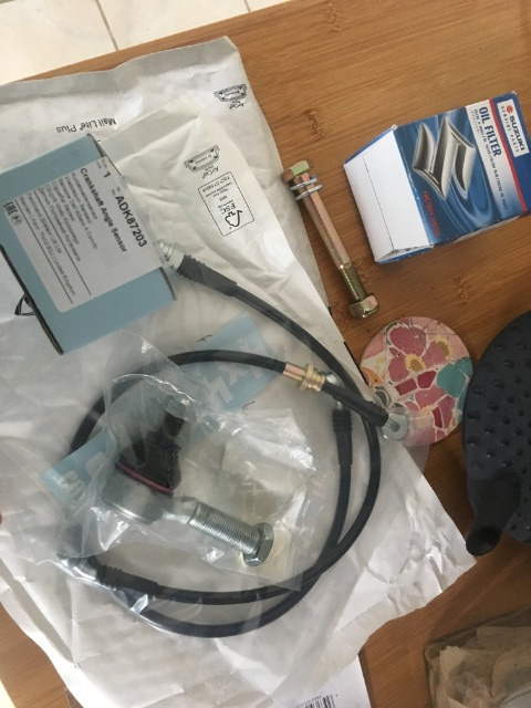

Crank sensor, radius arm bolt, oil filter and tie rod end arrived - Martin - that is amazing service, thank you.
Extended brake lines from Llama 4 x 4.
Crank sensor fitted.
Tie rod end fitted.
Went to do the brake lines to find the bleed nipples unwilling to turn.
Have to get some more bleed nipples and then I can apply some heat and more force to these stuck ones to persuade them to leave.

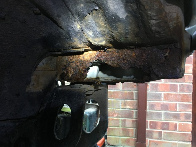

Popped off the bumper and driver's side wheel arch liner to deal with the white plastic clips that resonate when I accelerate.
It looks like the tin worm has been busy. I suspect the other side may well be similar. After a few light taps with a hammer...
Gave it some rust treatment to slow it down - will get new metal welded in place in the spring.

Martin can supply complete replacement panels for that area.

Awesome - thank you.
