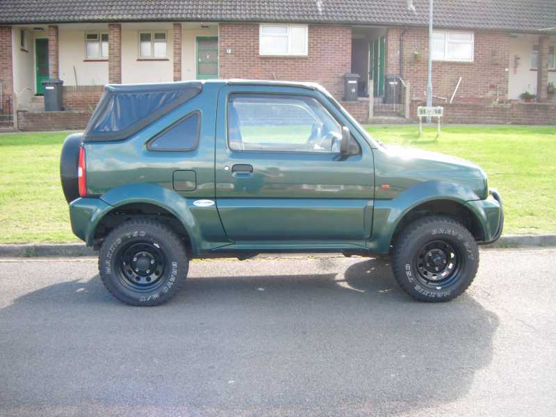

I think you should remove the spacers the jimnybits 2" is all you need.
But your doing a nice job on the jimny so keep up the good work .
This my jimny with just the 2" lift.
2002 JLX Soft Top
