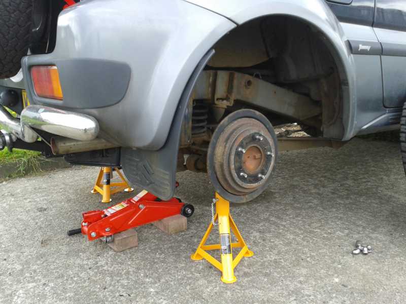

by Halford
met a man in his reasonably priced Jimny :laugh:
who did a reasonably priced rear brake overhaul
and I did a bit more debadging :whistle:
many thanks Gaz, great job, I can feel the difference

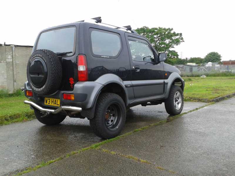

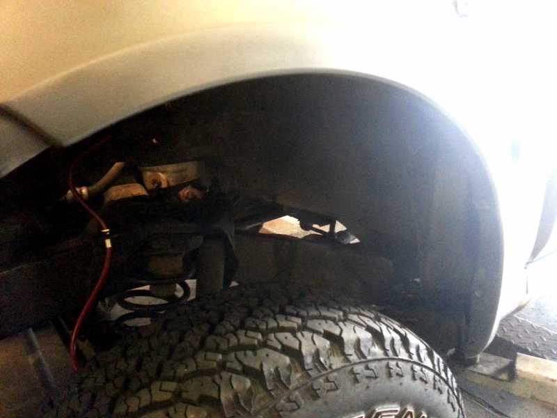

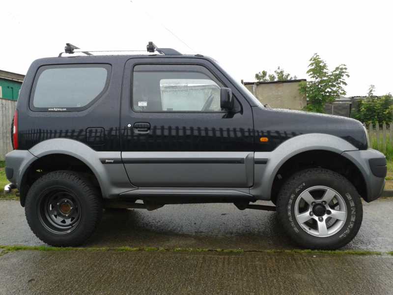

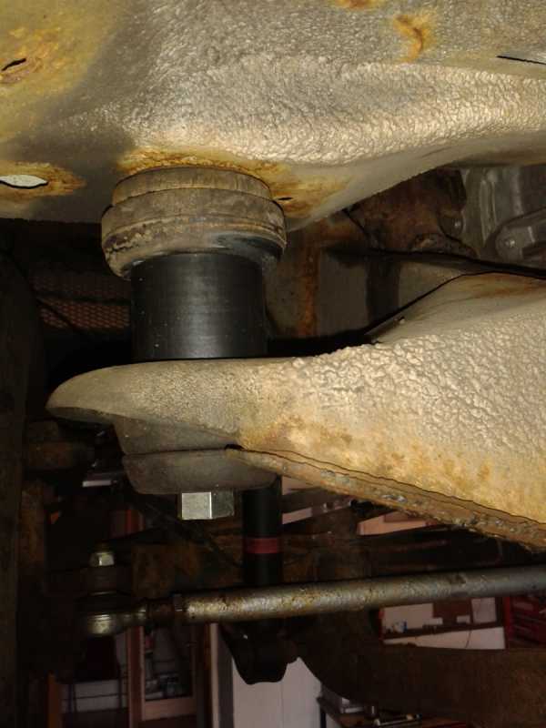

26 Jun 2015 16:33 - 02 Jul 2015 14:21 #146639
by Halford
:woohoo: happy bunny

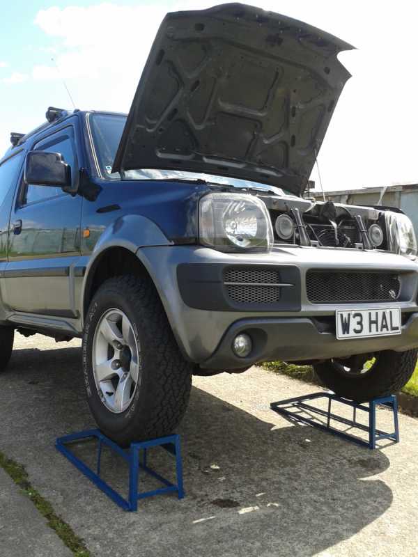

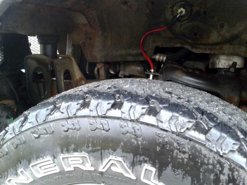

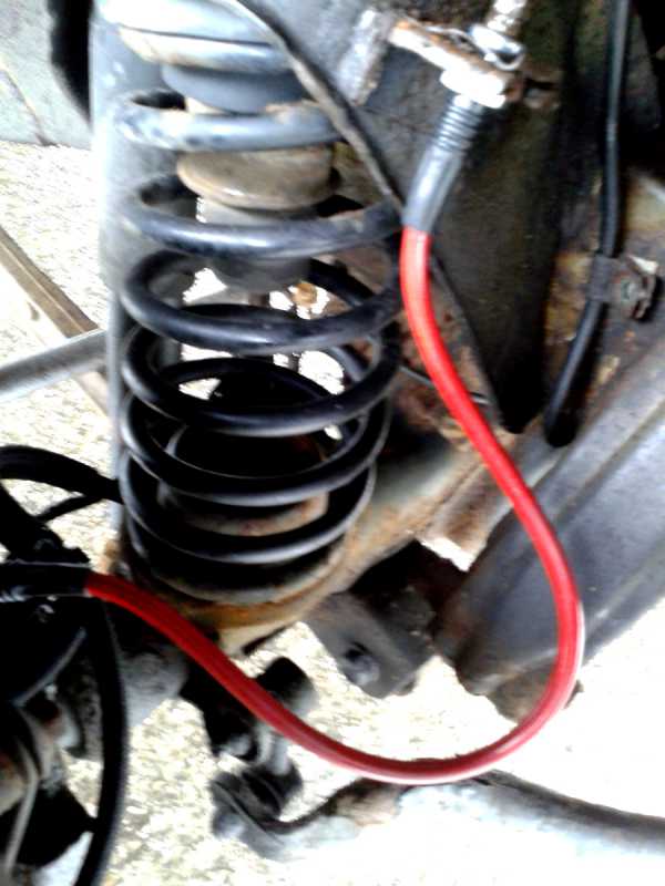

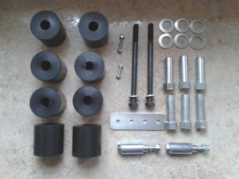

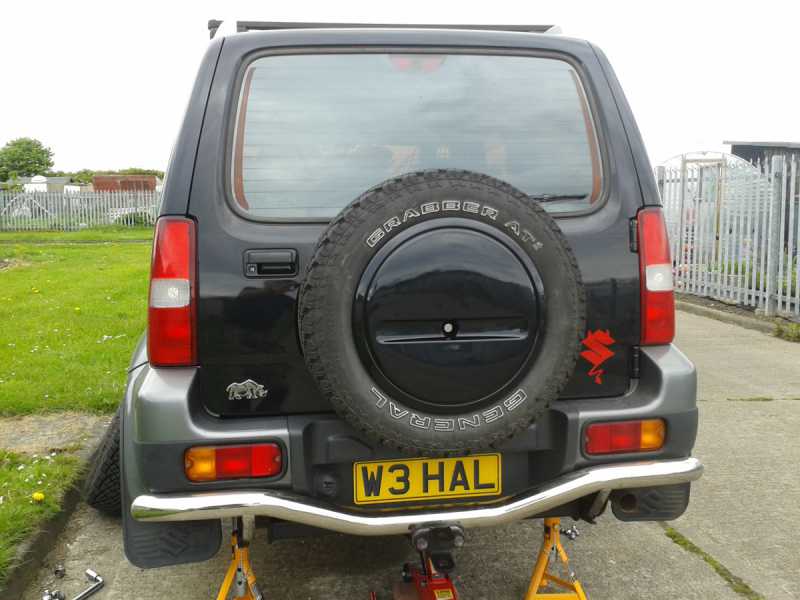

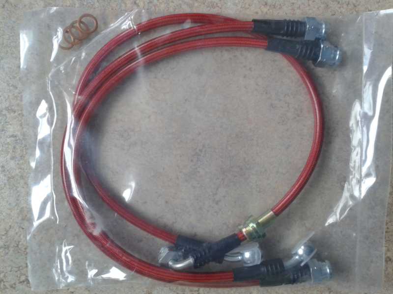

2 inch body lift and extended brake lines fitted .......... thanks to Gaz and Chris.
Jimnybits 2 inch kit
and Bigjimny extended brake lines

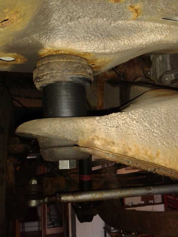

spent a few weeks before the planned fitting date spraying and spraying with penetrant - body lift mounts, brake line couplings, steering rod linkage, air box, headlight, bumper fittings ... and anything else that got in my way.

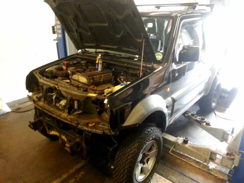

but tried to crack the body mounts off and :ohmy: solid, severe risk of snapping off :pinch:
no alternative but to go for plan B ...... book into garage on ramps and have heat and voodoo magic applied
on they go ...........

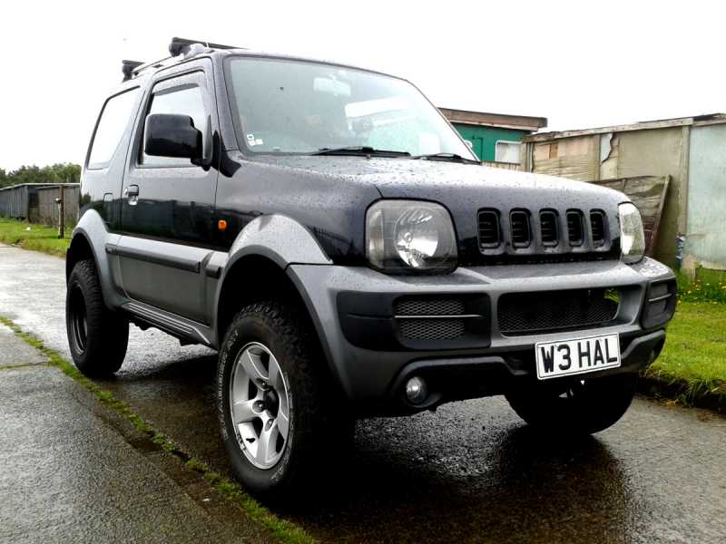

before with 1.5 inch spring spacers and shock extenders
and after the body lift
well pleased love it ........... :woohoo:
But there's a lot more involved than peeps would have you believe, need to lengthen vac hoses on post 2005 trucks, need to loosen wiring looms, front and rear bumper mounts need changing, steering rod is a real pain to get off and fit spacers, gear knob is two inches lower down and inner gator needs modifying to enable slick gear changes .... etc etc
now just need to save for 3 more -30 offset steels and fit big BF's, then a 2 inch suspension lift :whistle:
EDIT: forgot to mention ..... the ride is much improved, softer, less crashy .....
couple of pics that Gaz took
edit ... additional pic ........ probably why it rides so much softer now ..... padding

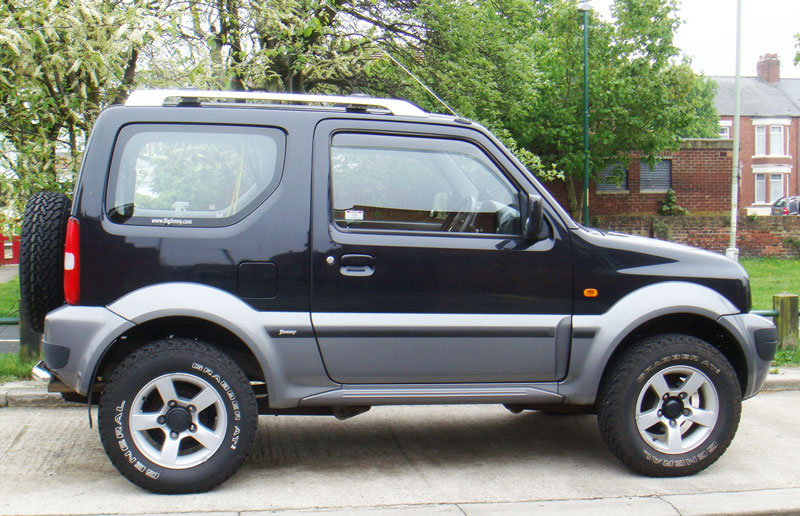

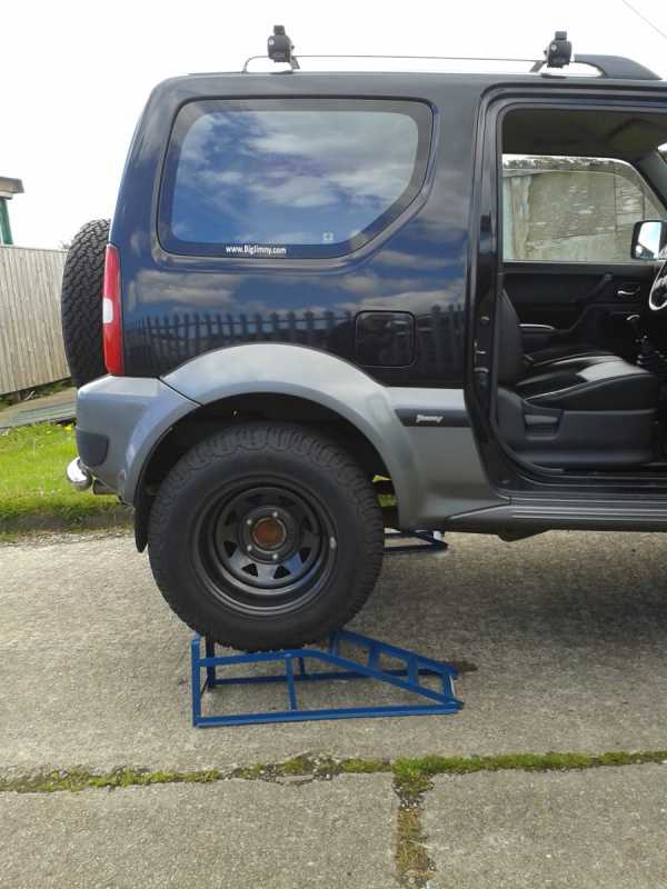

26 Jun 2015 16:59 #146644
Yes, it's funny how things like that are overlooked.
Looks nice pal but really, the front wheels??
Replied by helijohn on topic Halfords Dog-Taxi
