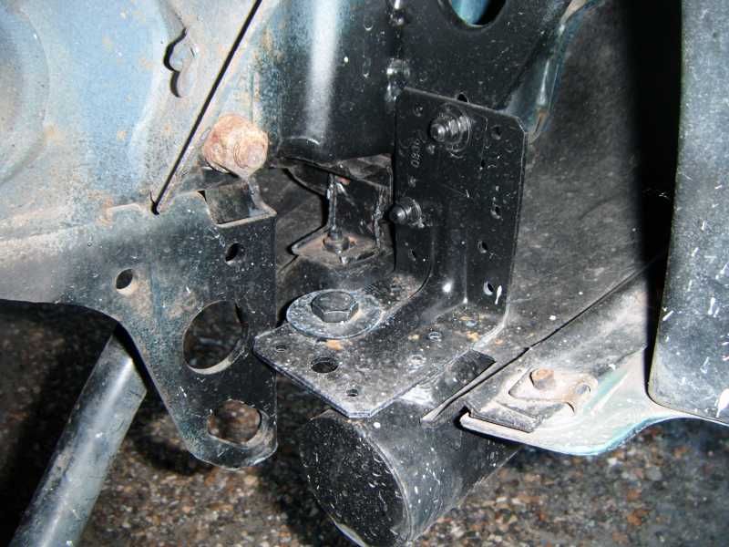

The big bolt with the washer, bolt the bracket to the a bar, and the two smaller ones bolt on to the jimny support bracket at the back of the bumper

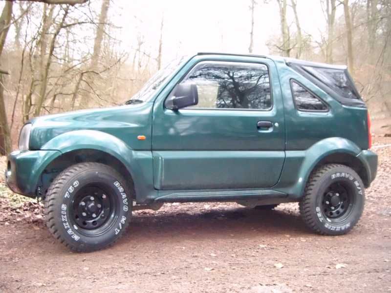

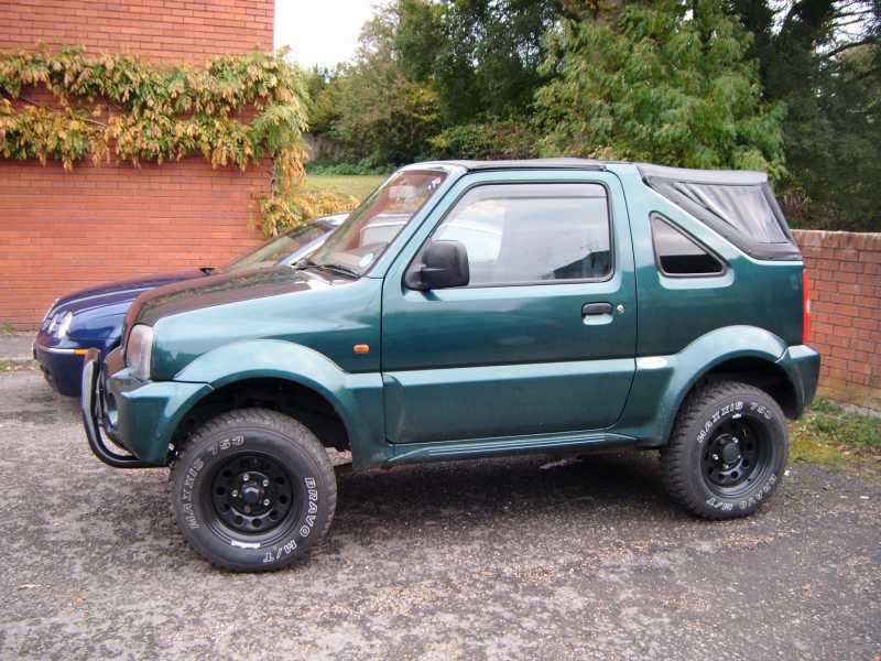

Received my 2" lift from Jimnybits on Tue 4 Oct, fitted on Sat 8 Oct, the job was very easy to do about 4 hours to fit +4 cups of tea.
The first photo is with 1.5" spring spacers
www.jimnybits.co.uk/shop/index.php?_a=viewCat&catId=1
Before
1.5" bits4vits spring spacers.
After
2" inch lift with Pro Comp ES1000 shocks
Before
After

Its getting taller! :laugh: Nice job, looks awesome. What tyres are you running. I running muds all the time and iam looking into some AT's.

Maxxis 753 Bravo m/t 205/75/15.
26MPG DOWN HILL
