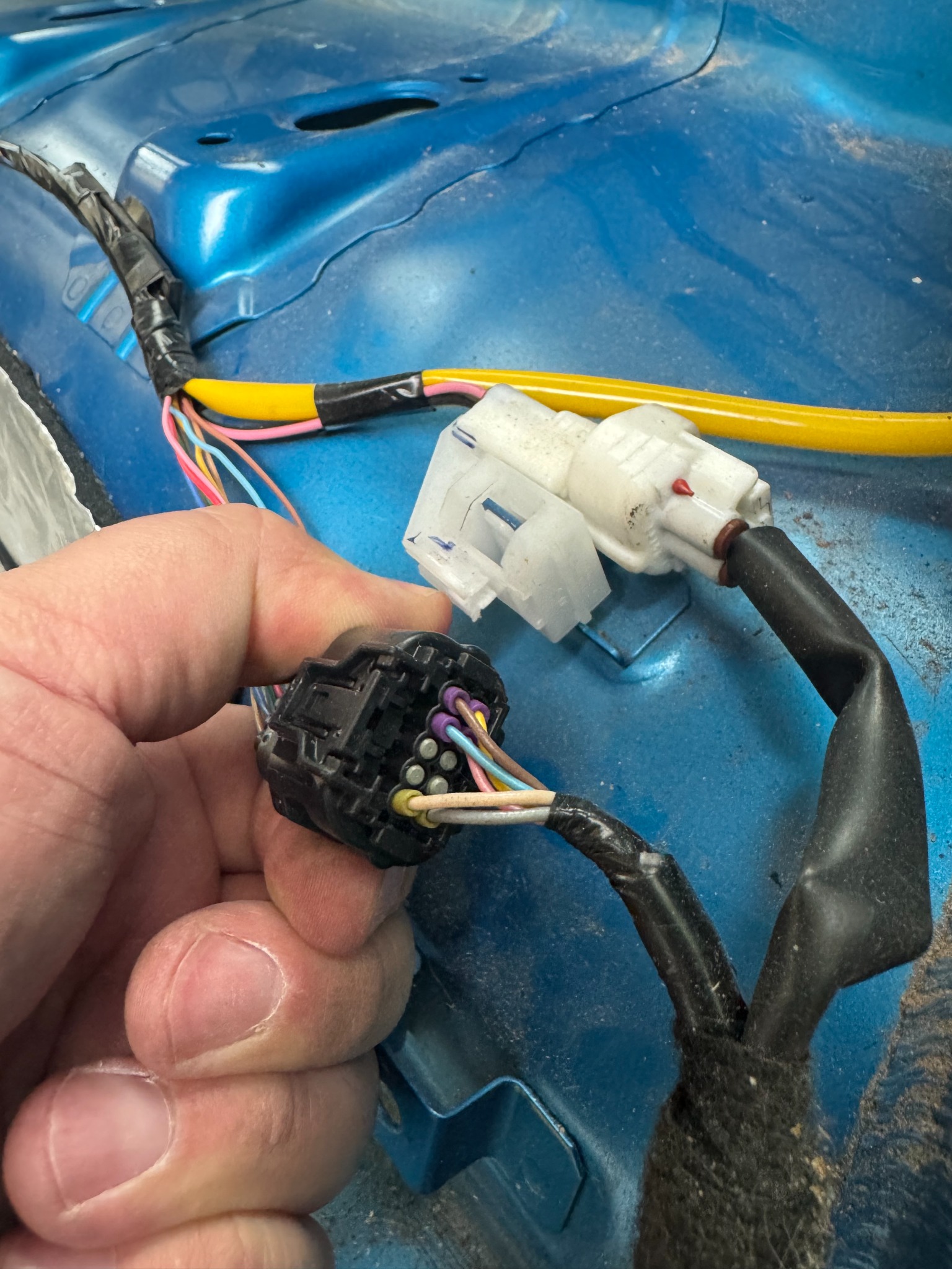

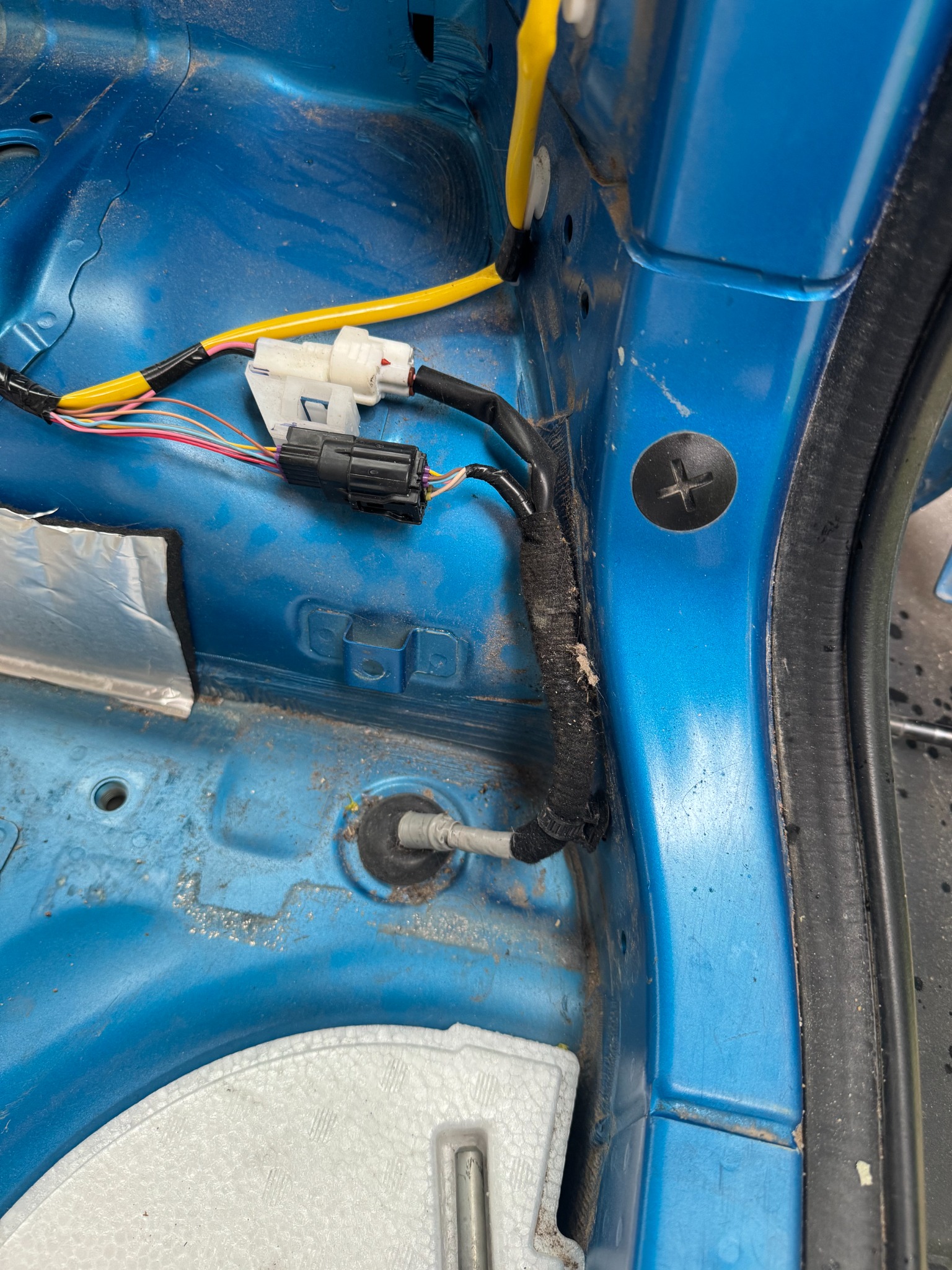

It's a big mistery. I know this car has additional wiring for a tow bar, but it comes from a hole on the left side of the cabin, and the wiring loom for the sensors (abs, fuel tank) comes from the right. I even took a picture of the loom in the cabin side. Do you think the loom was changed from a different model without a sensor? I can't think of a reason why would they do that, but seems like the only logical explanation.
Dealer says the whole loom from the front to the back of the car is a single SKU and the price is astronomical. I really want to fix this, already purchased a lot of things and only need to figure out the connection. If someone knows the pinout of the connector from the picture, it could help me a lot.

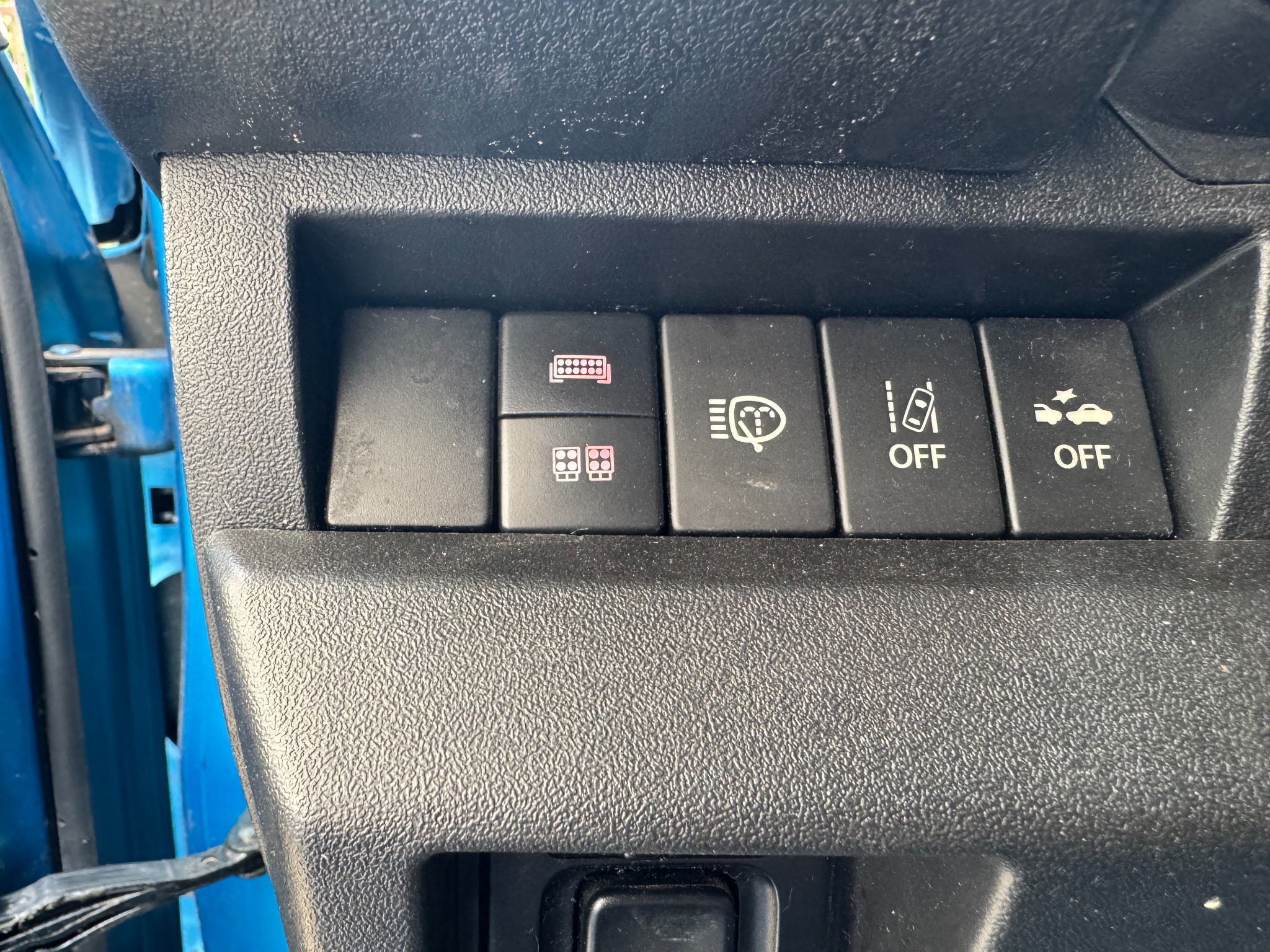

I'm not really familiar with the GLX spec, but LED headlights, sounds similar to the UK SZ5 spec. Has yours got the headlight washer jets in the front bumper, and there is no manual height adjustment in the lower dash near the steering wheel?
13 May 2026 09:12 #264417
by Jacket
Replied by Jacket on topic Gen4 headlight leveling sensor mistery

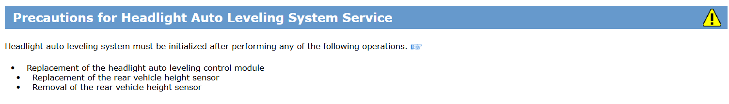

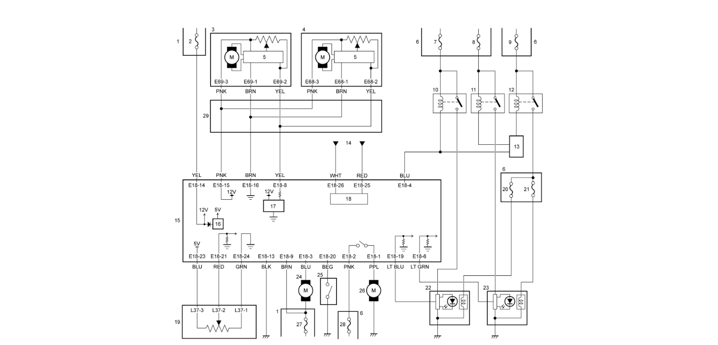

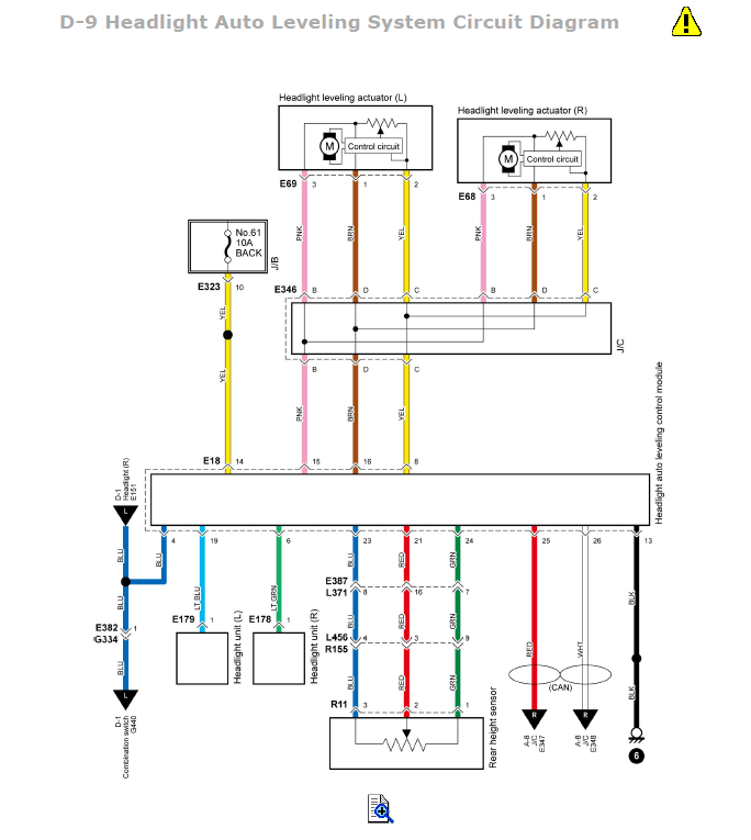

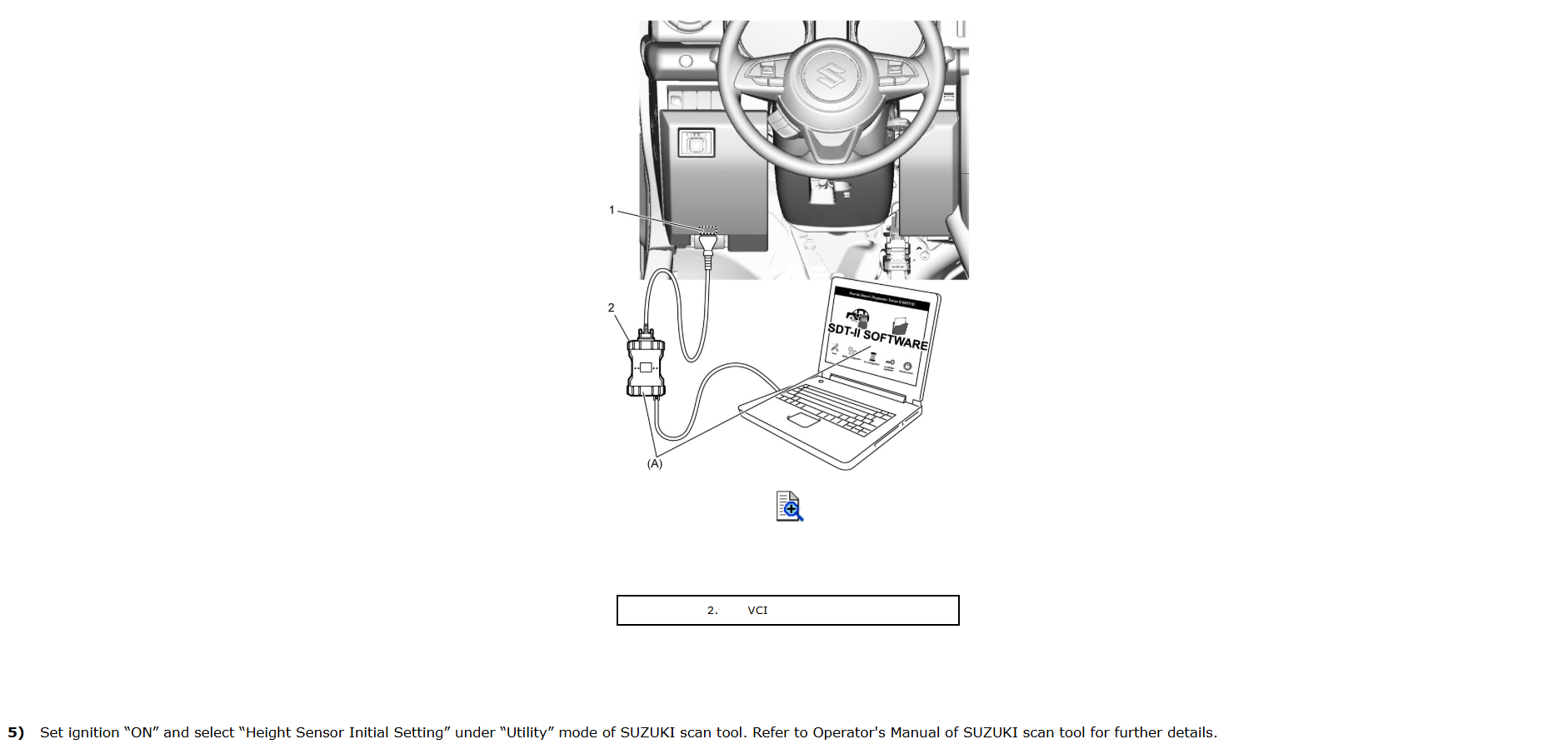

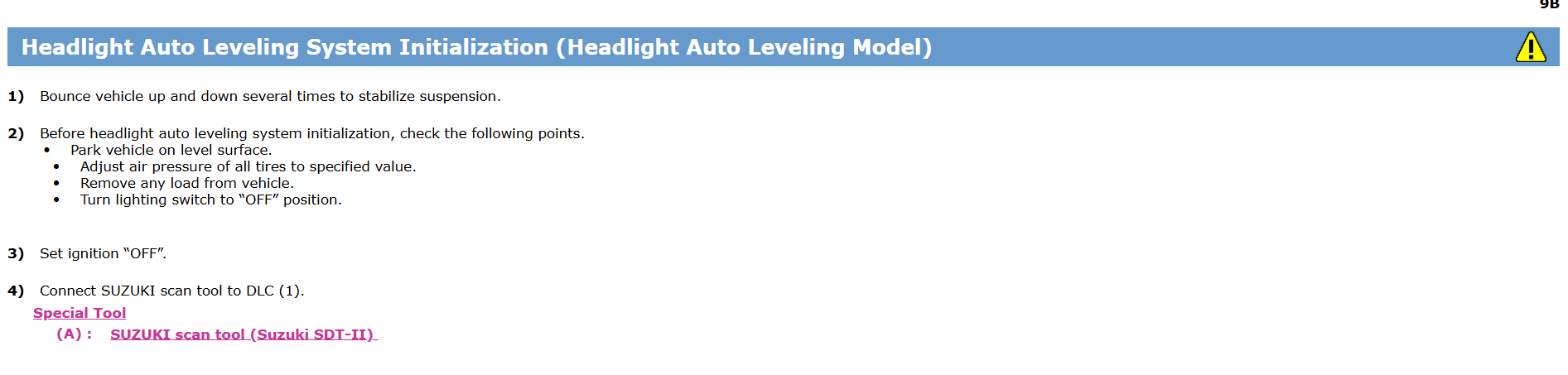

I'll try and have a look at the wiring diagram as soon as I can.
13 May 2026 12:29 #264421
Replied by Soeley on topic Gen4 headlight leveling sensor mistery
13 May 2026 19:31 #264425
by Jacket

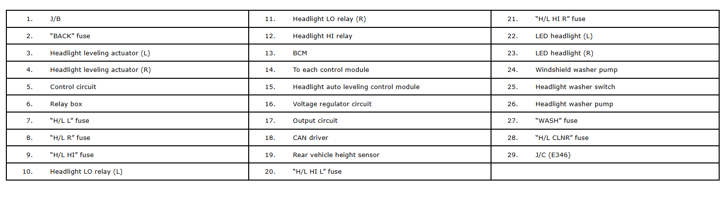

Thank you for the diagrams. I definitely don's see RGB wires on the loom after the connector in the cabin, so it must be from another car. I think I see RGB wires on the loom before the connector though. So I will need to tap into those and route my own wires to the sensor. I think this should be enough. Thank you!
