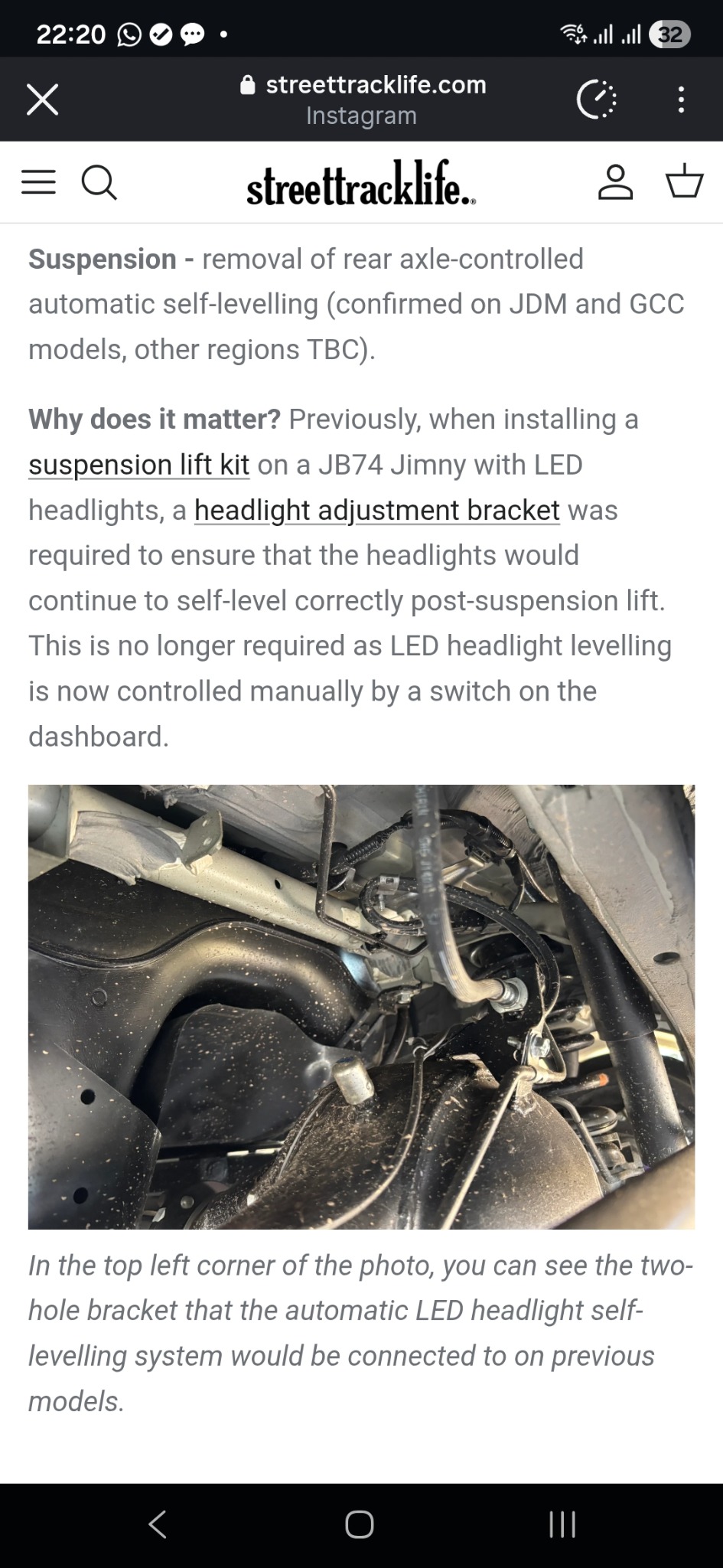

Replied by Soeley on topic Gen4 headlight leveling sensor mistery
This made me think of your Jimny, although yours is a 2019.
www.bigjimny.com/forum/6-jimny-chat/7158...-need-to-know#264464

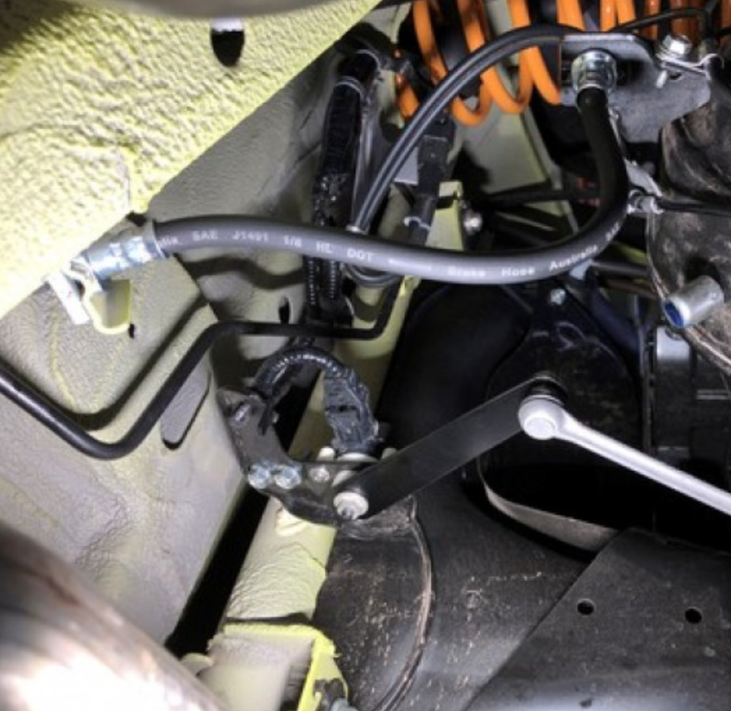

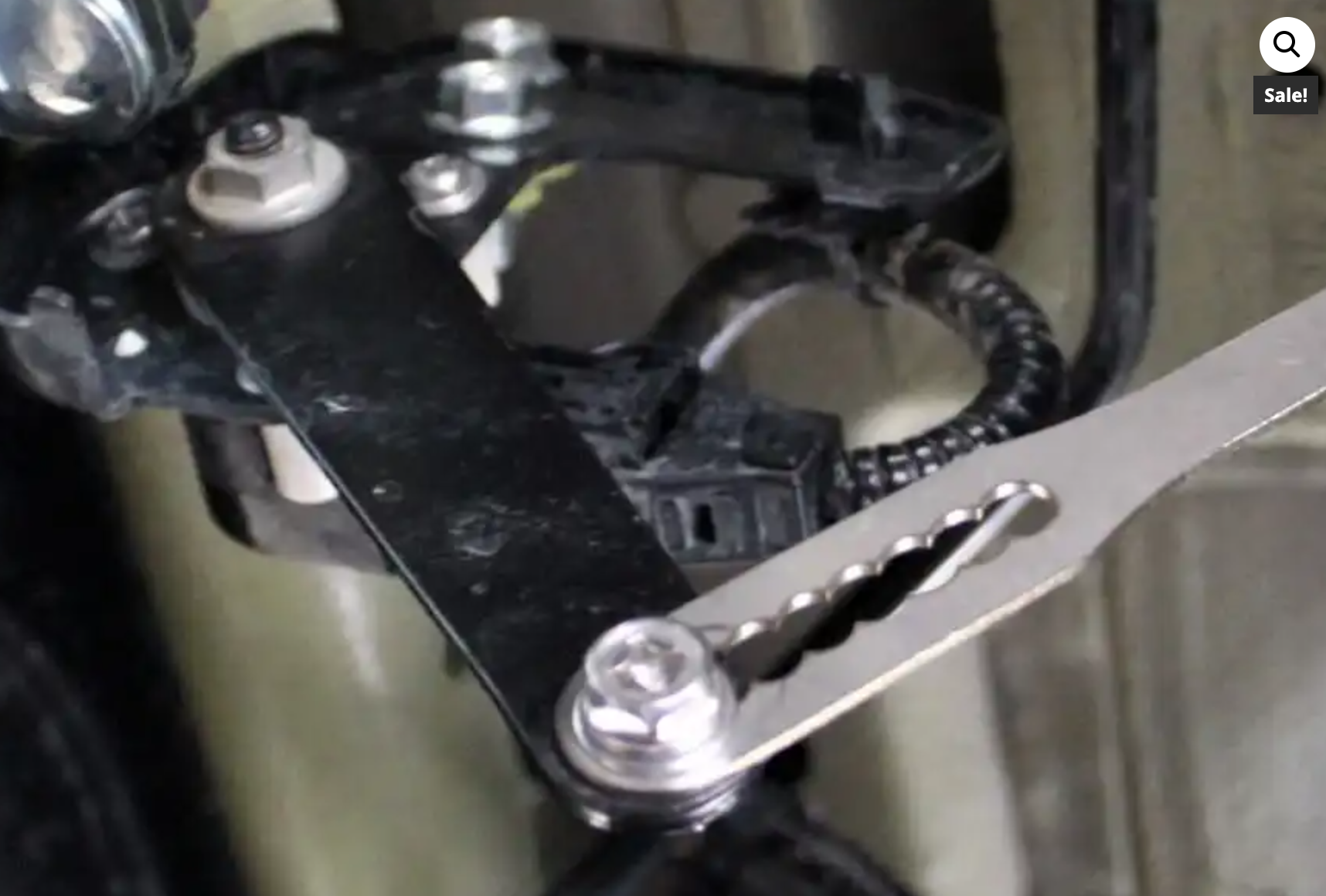

And here are couple of photos from the internet of the connector. I can't find better ones.

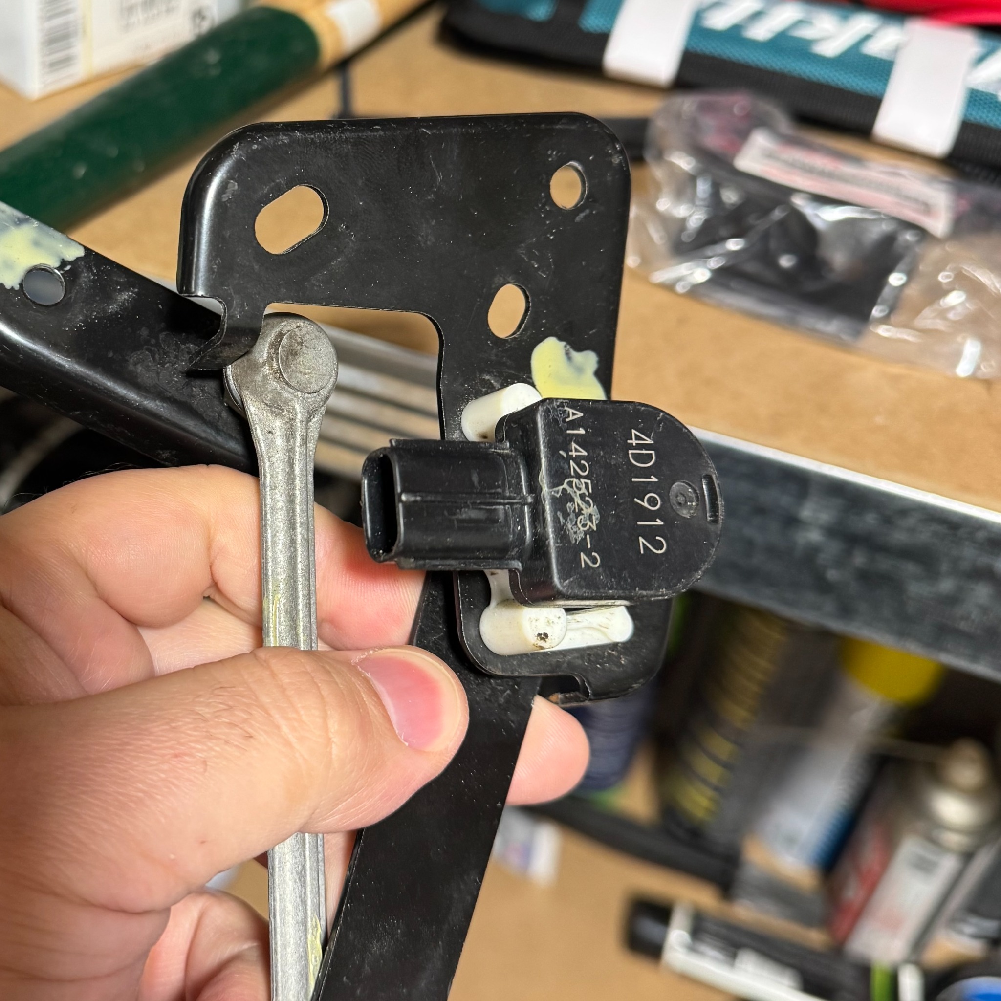

Replied by Jacket on topic Gen4 headlight leveling sensor mistery

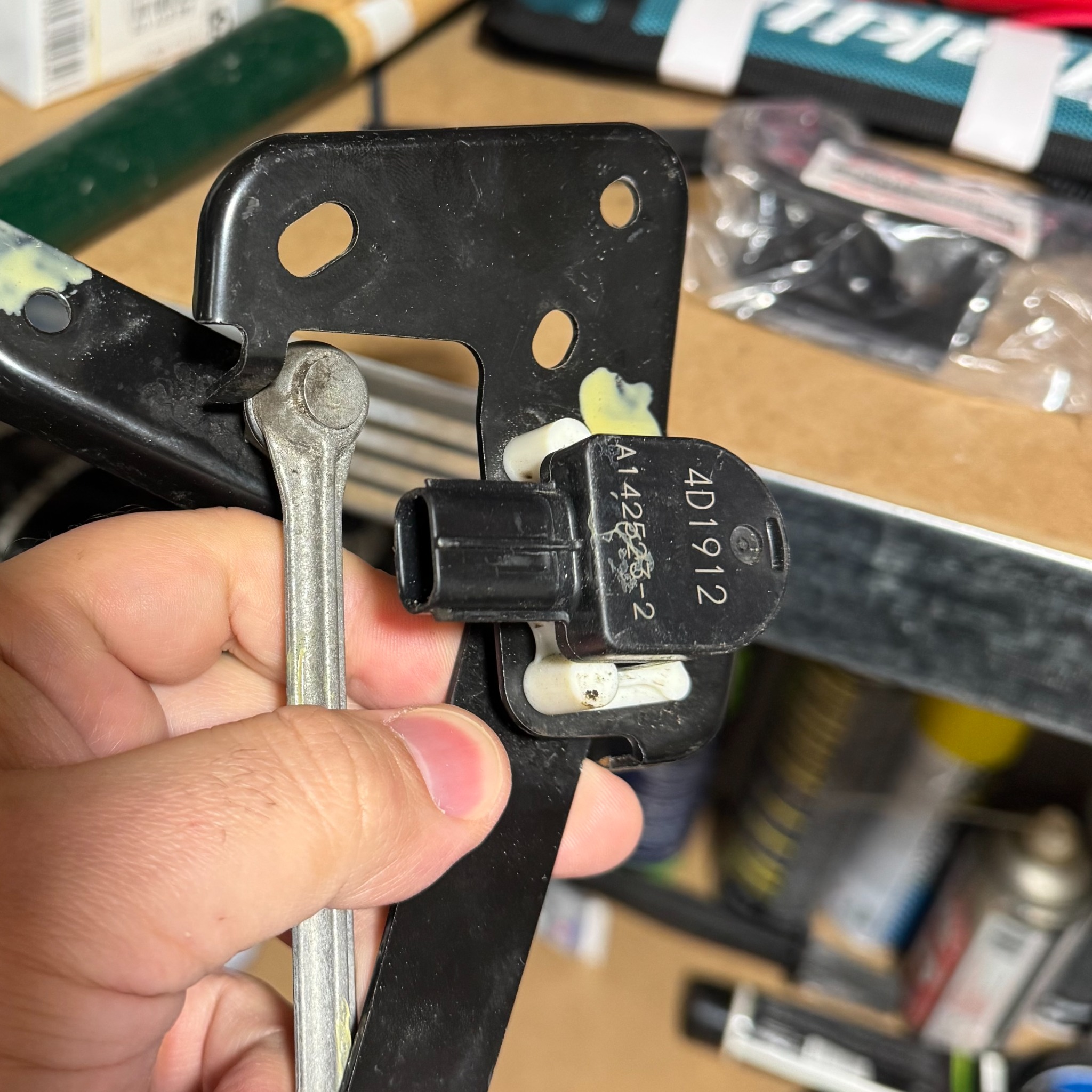

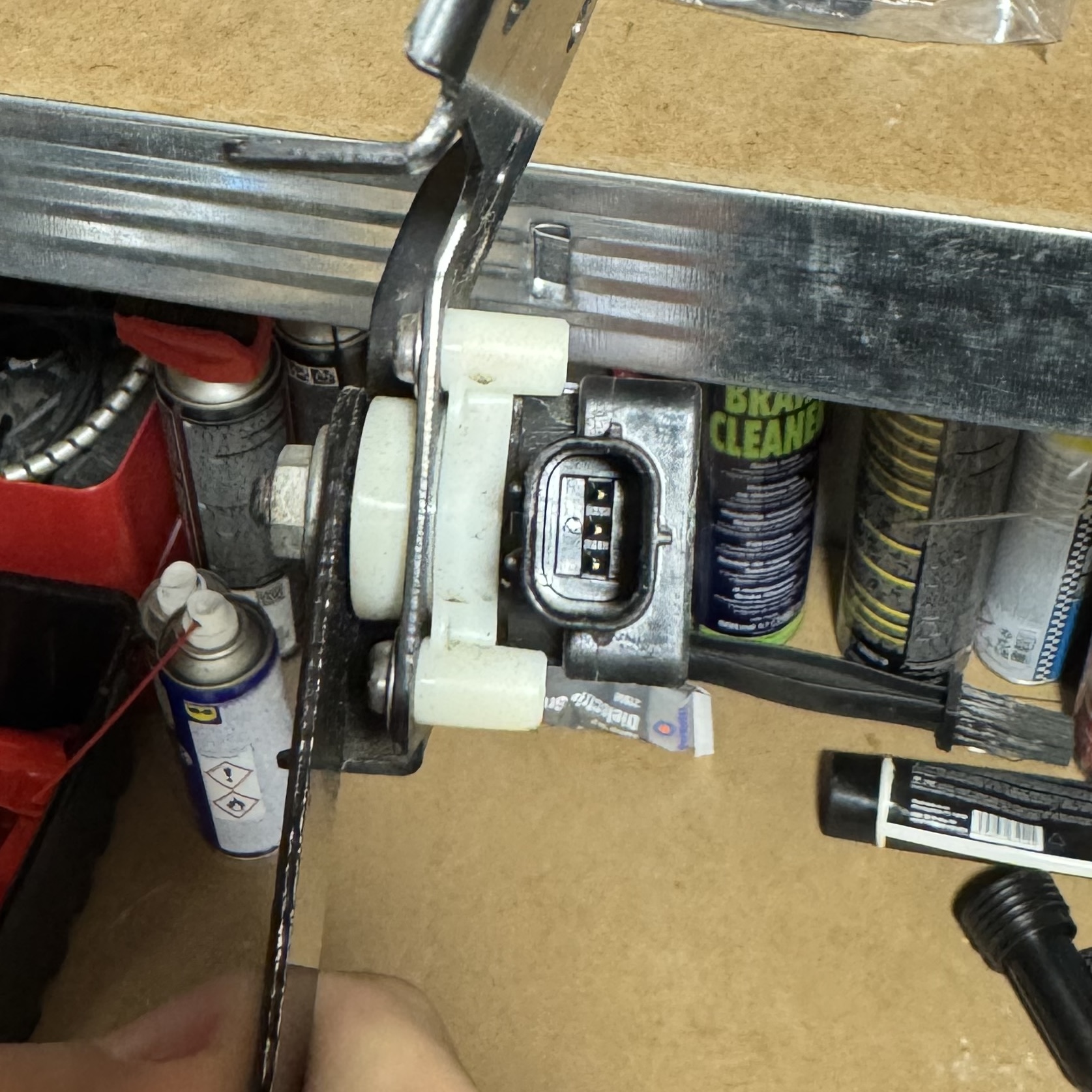

Tanks! Obviously I don't have the connector with me, but here are couple of closeups of the sensors that I bought. It should be a inline 3-pin connector with 5 specific notches to fit the sensor.Most of the connectors on the Jimny are pretty much common with Toyota connectors, so its worth looking around.
Send some clear pictures of the required connector and I will have a look
