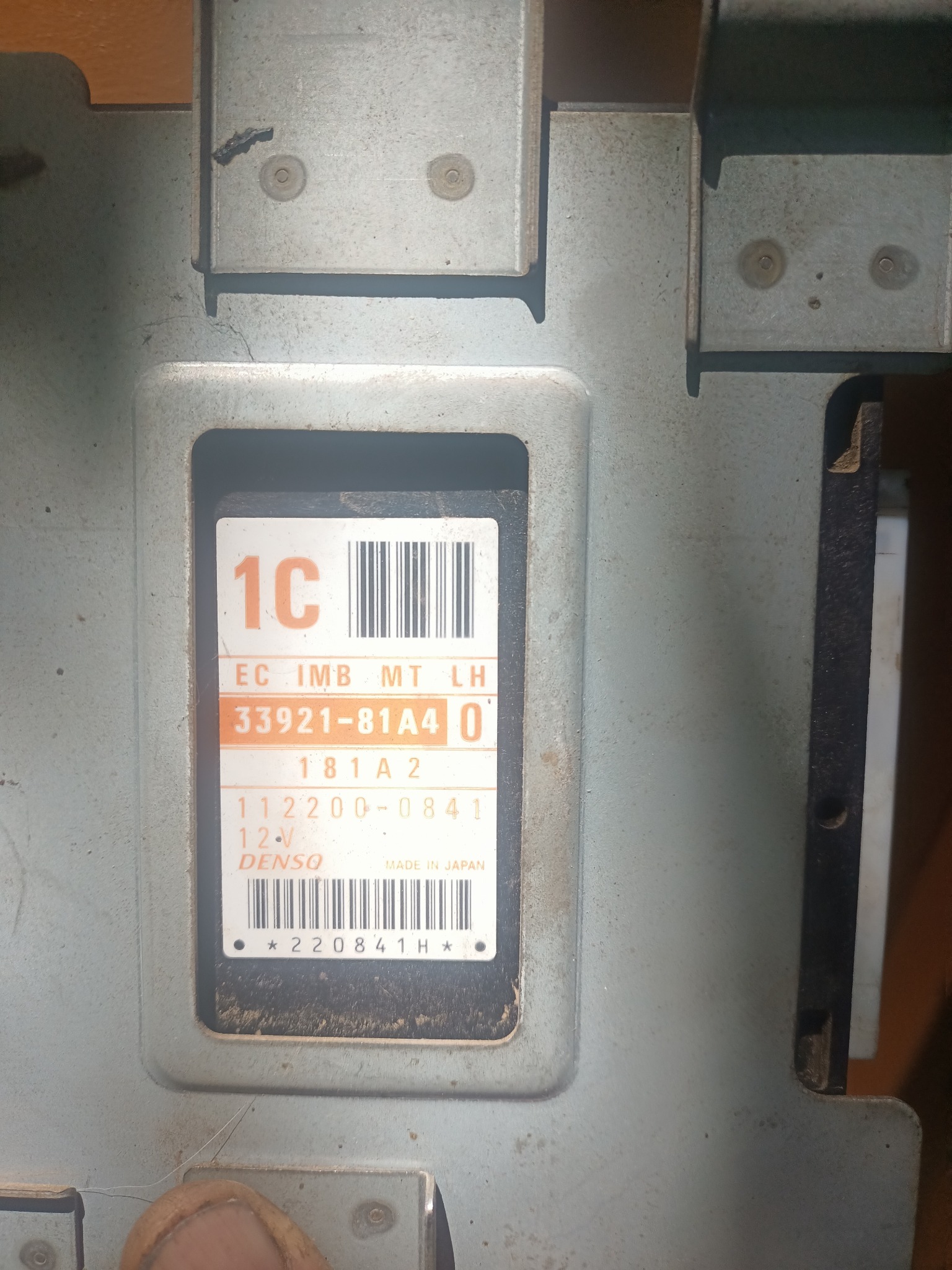

ECU:
Brand: DensoSuzuki code: 33921-81A4Denso code: 112200-0841

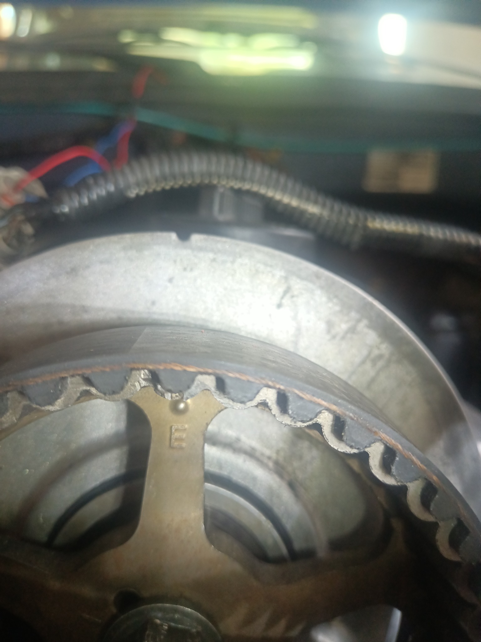

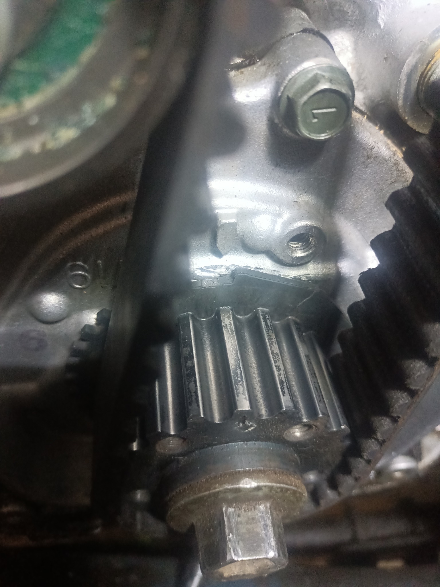

- Replaced cracked cylinder head with a reconditioned one.

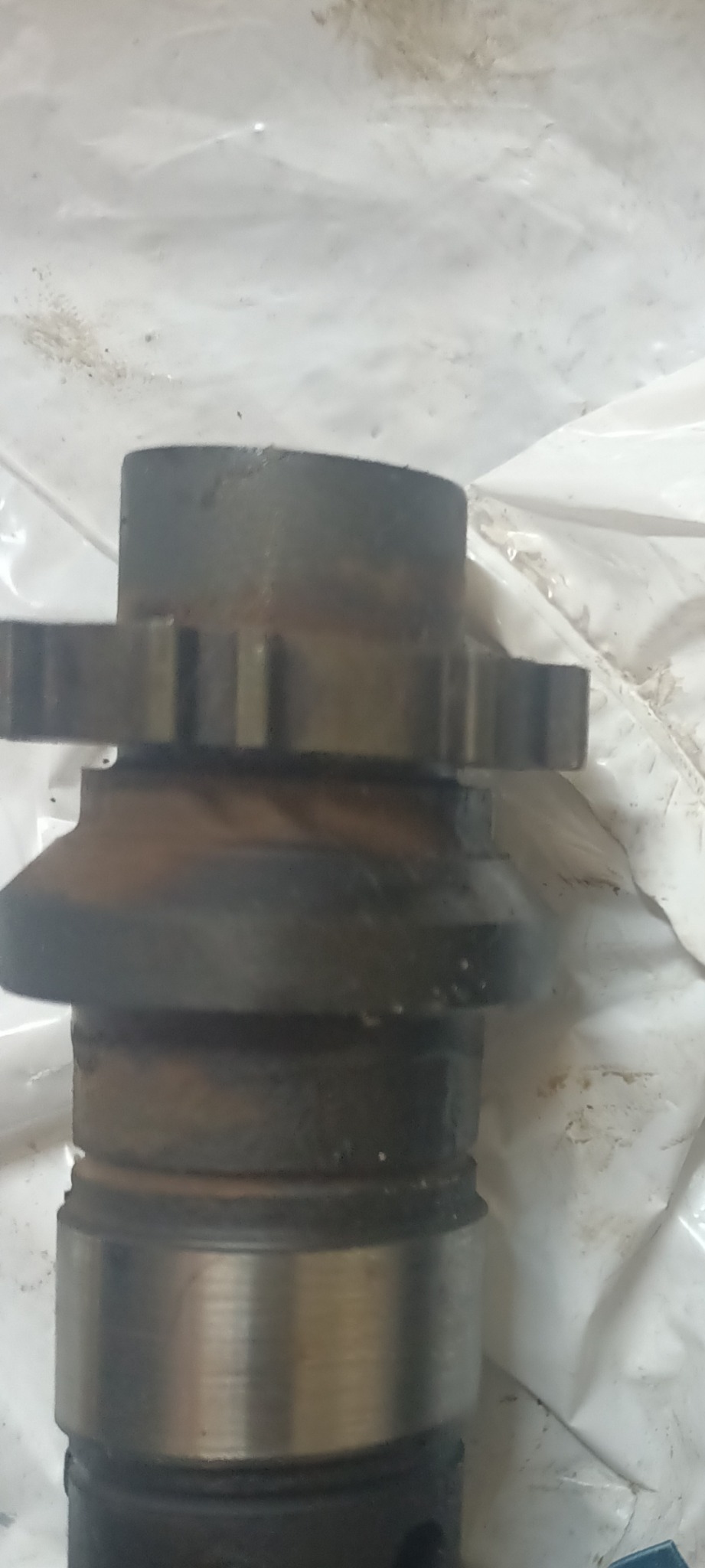

The replacement head came with a different camshaft trigger wheel, so the original camshaft was reused.
Original:
New one:

Is a refurbished cylinder head, complete, pressure tested. The camshaft is mine from old cylinder head.
Both crankshaft and cameashaft are aligned at marks.
