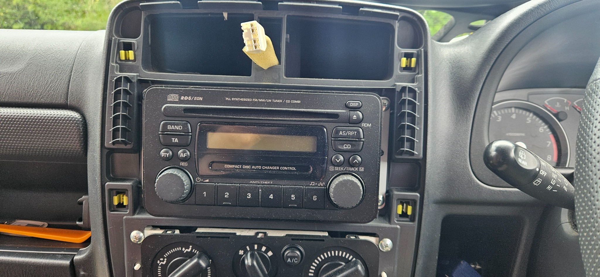

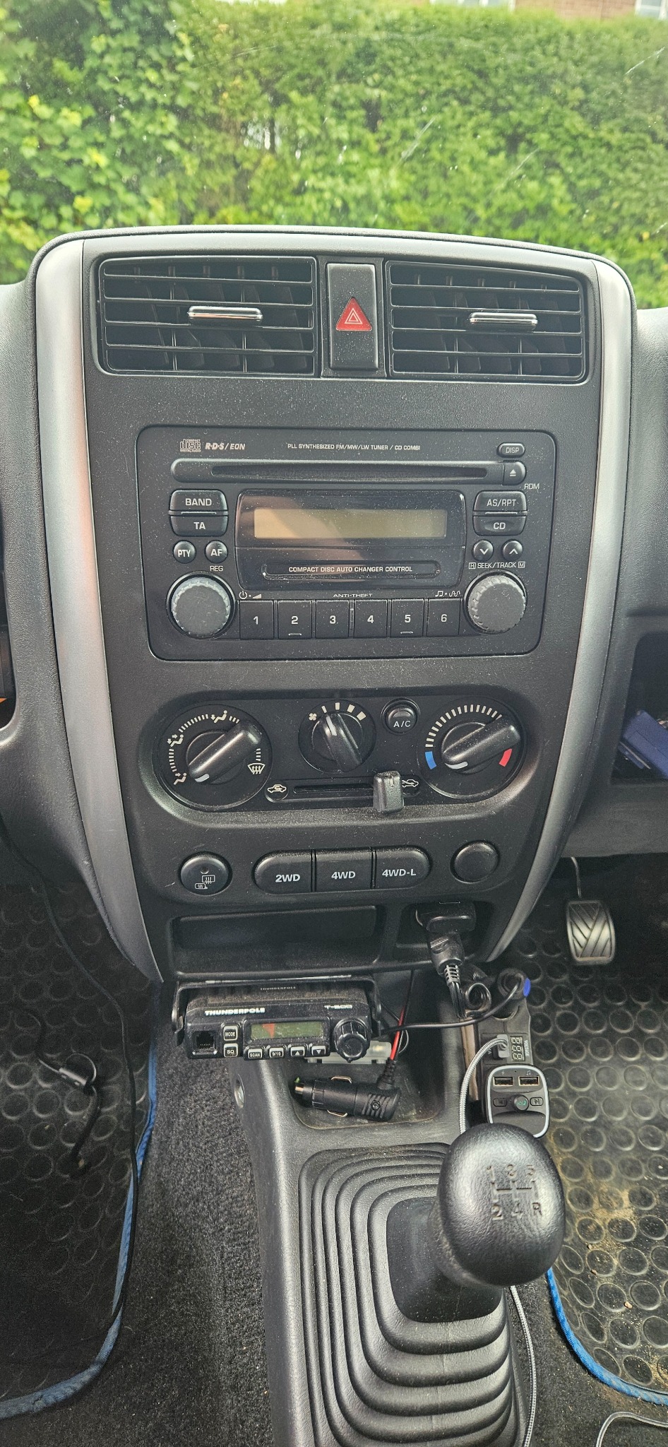

My Jimny is a 2011 and this is what I was working with to begin with.

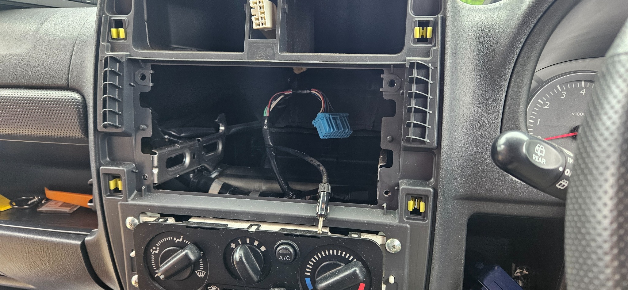

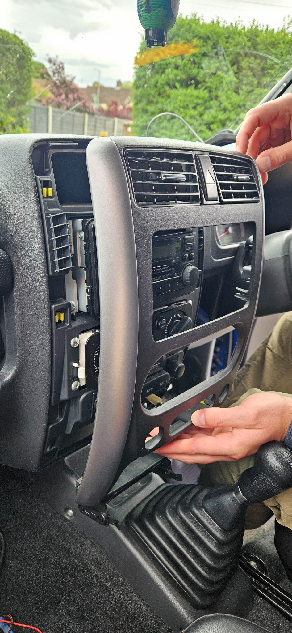

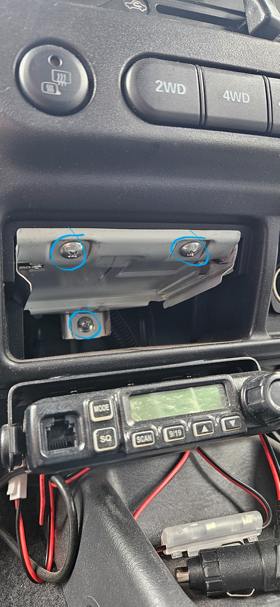

The first thing you are going to need to do is remove the ash tray/bin and take out these three screws. After doing this you will be able to use your trim tools to take off the whole front facia. There are three clips down both the left and the right hand side, which will come out quick easily with a little persuasion.

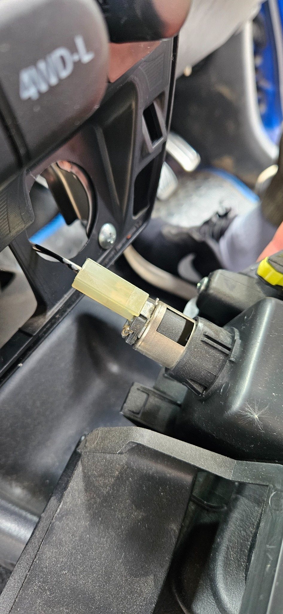

With the facia unclipped, you'll just need to unclip the hazard light and the cigarette lighter, again they are tiny clips but will release with some persuasion.

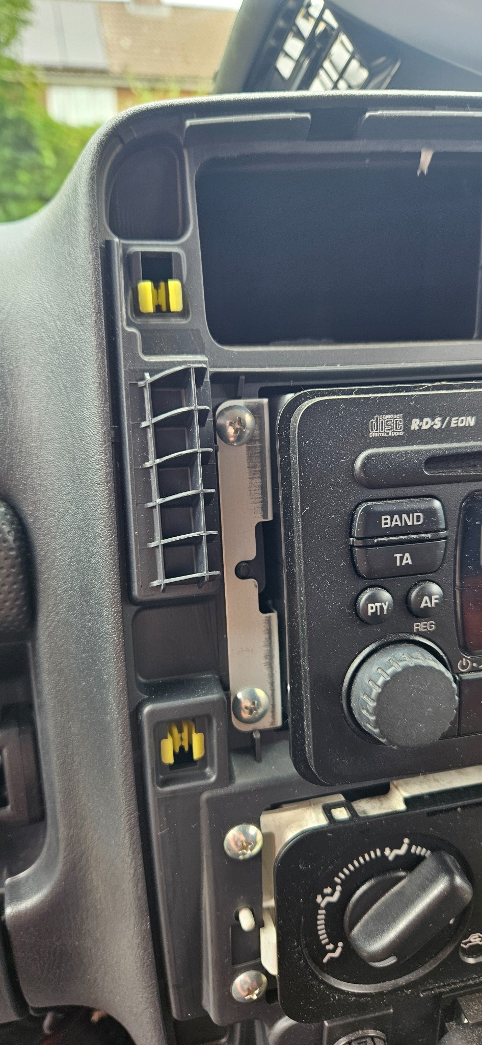

Next we need to slide out the old unit, this is held in by 4 screws and then will pull out. It sits within a carrier that follows along some tracks.

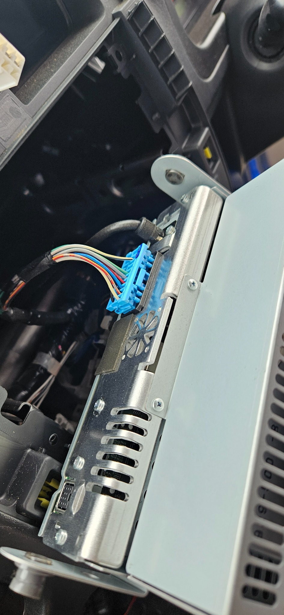

Once this is out you'll need to unplug the unit, mine was both the power and the radio.

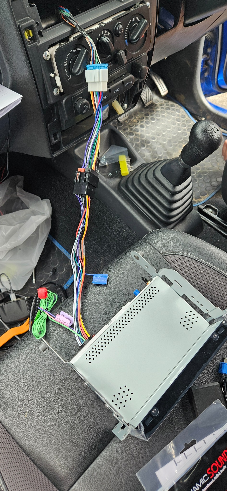

The Pioneer Unit comes with a carrier already attached, as I needed to utilise the carrier for the old unit I undid all the screws from the old and moved everything over to the new. I think I got lucky here as I didn't measure how inset the unit needed to be in the carrier. but instead lined it up with both the back of the carrier and some matching screw holes. You can then attach the wiring harness to the power cable of your old unit and the cables of your new unit and leave to the side.

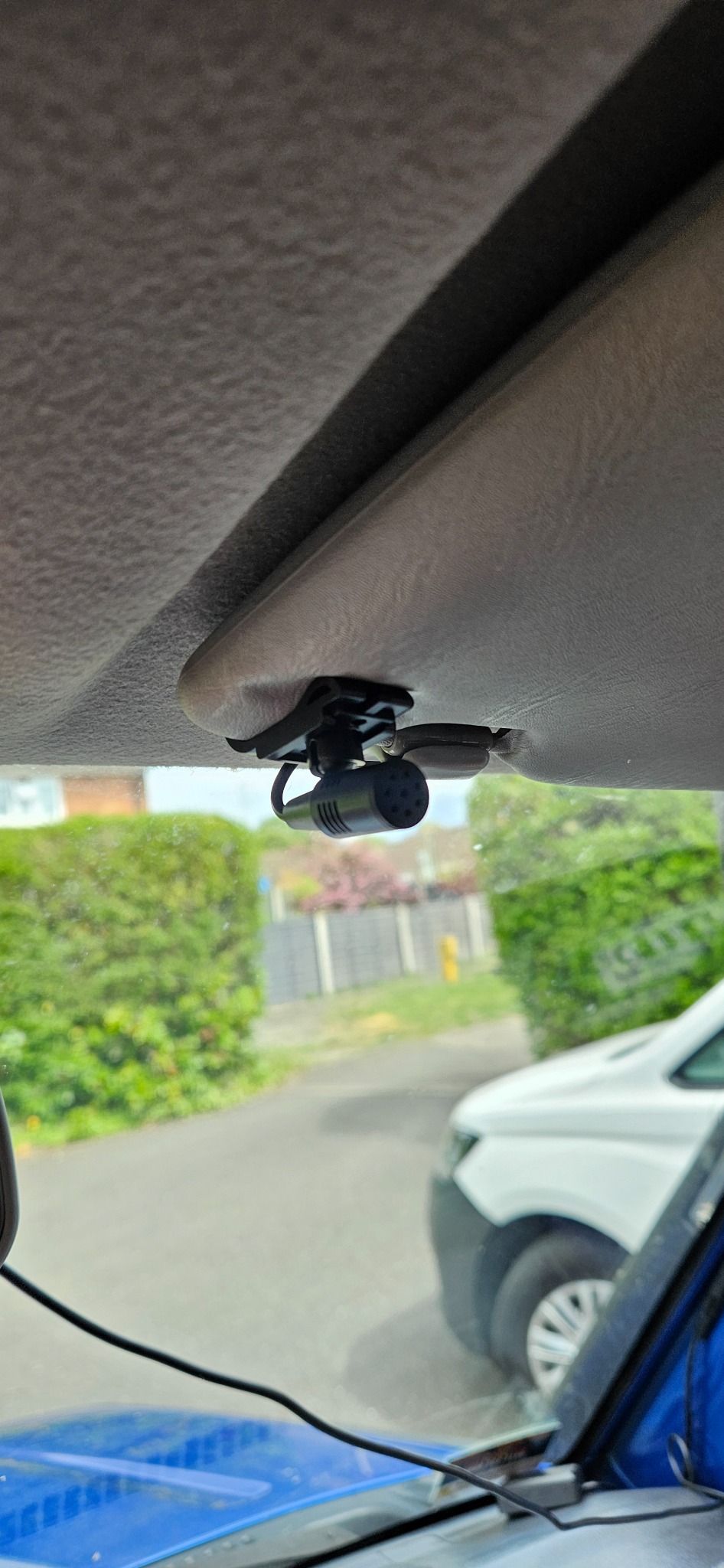

Now onto the cable management. This will all depend on what features your new unit comes with, and which of those you want to utilise. I took this opportunity to also run a cable for my dashcam, which was previously an eyesore. I decided to use the column on the drivers side as my place to hide wires, which comes off using the trim removal tools and is held on by two clips. The Pioneer comes with a microphone, which has an attachment to hook over your sun visors. I coupled this with the wire from my dashcam and pushed it into the roof liner and then cable tied to the existing wiring in the column.

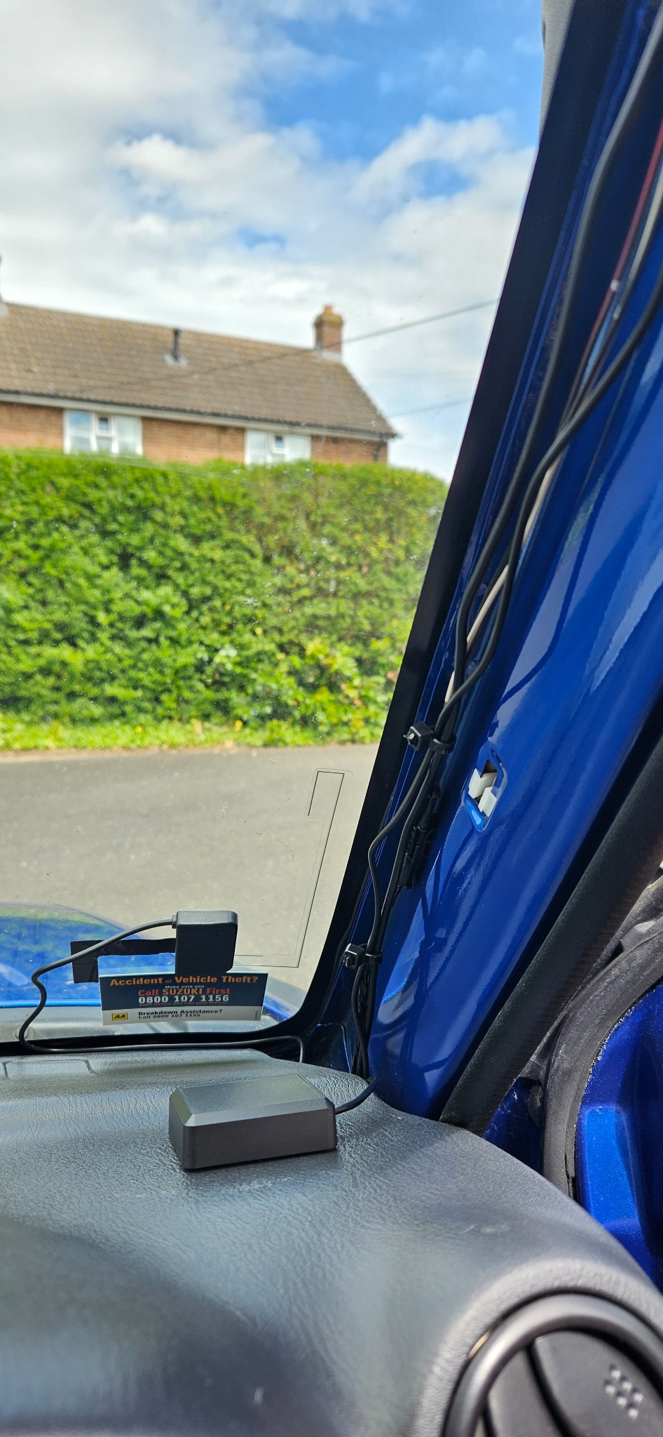

I then attached the DAB antenna to the front screen and attached the GPS to the dash as shown in the photo. All the wires went through the opening at the bottom of the column and after some wigging and hanging upside down by the pedals, we got them through to the hole in the head unit. I opted to cable tie them together and then also tie them onto one of the support bars, this was so they didn't rub on the steering column or have too much movement. Then you plug all the cables into their relevant spots and I ran the dashcam down to the 12v.

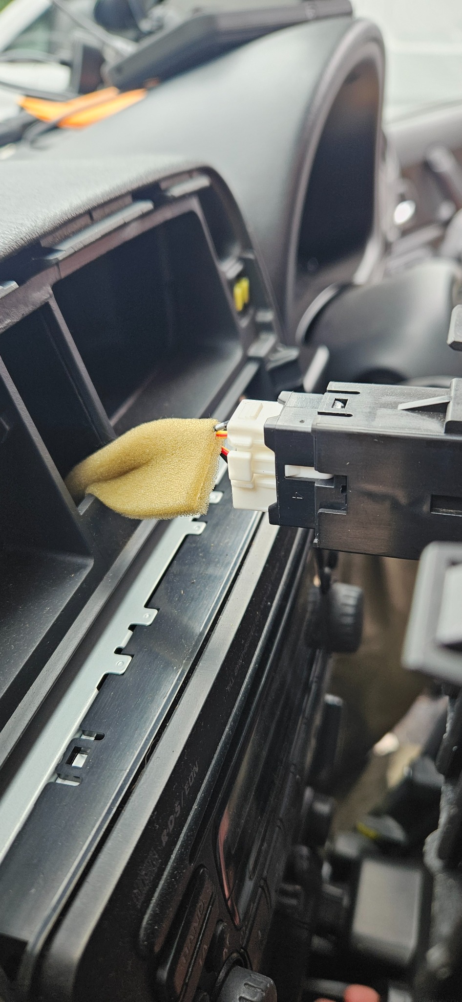

This is where my patience was really tested, you will need to strip everything off the old facia and move it onto the new. Hazard switch, 12v, air vents and the two silver side panels. You can get a special tool to remove the 12v which will make your life much easier, but we managed to get it with an allen key and a YouTube video.

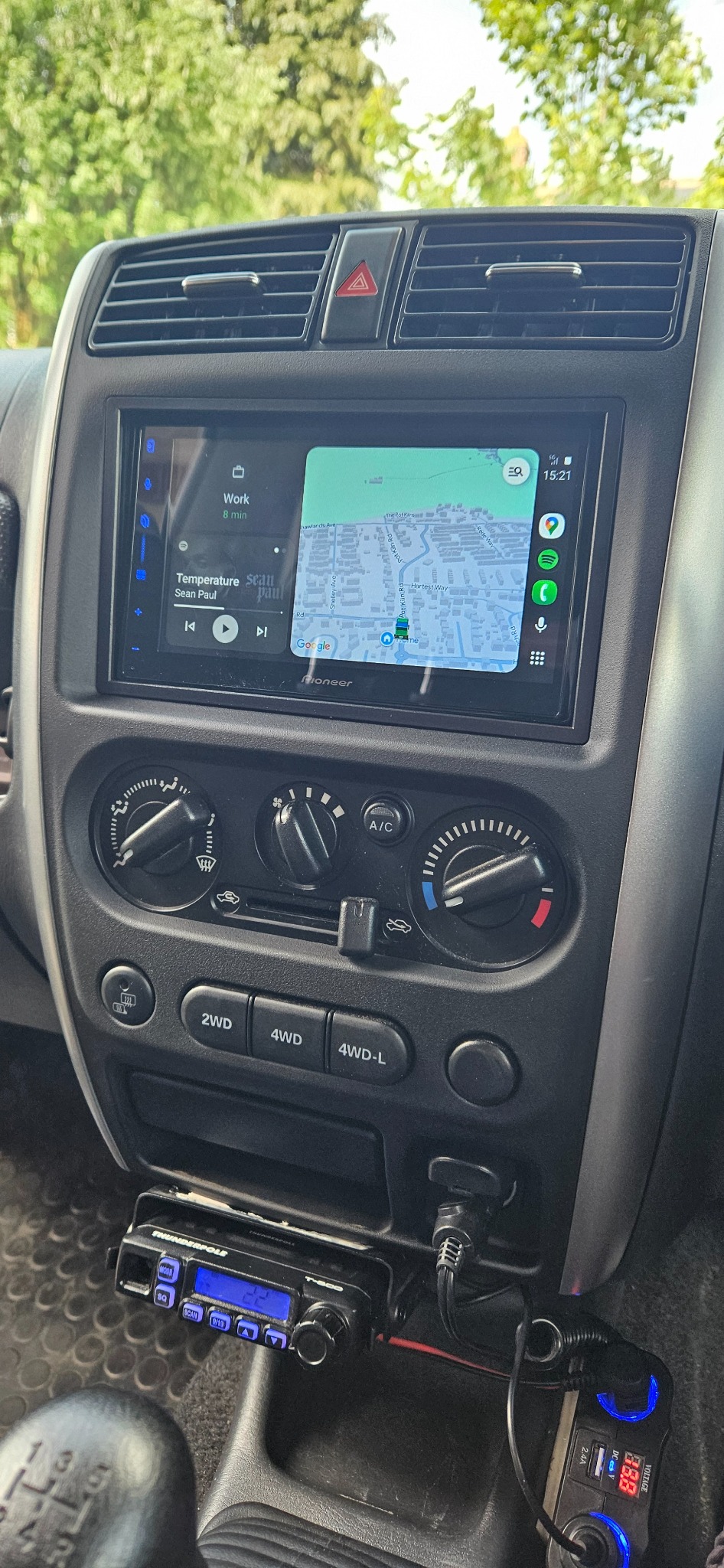

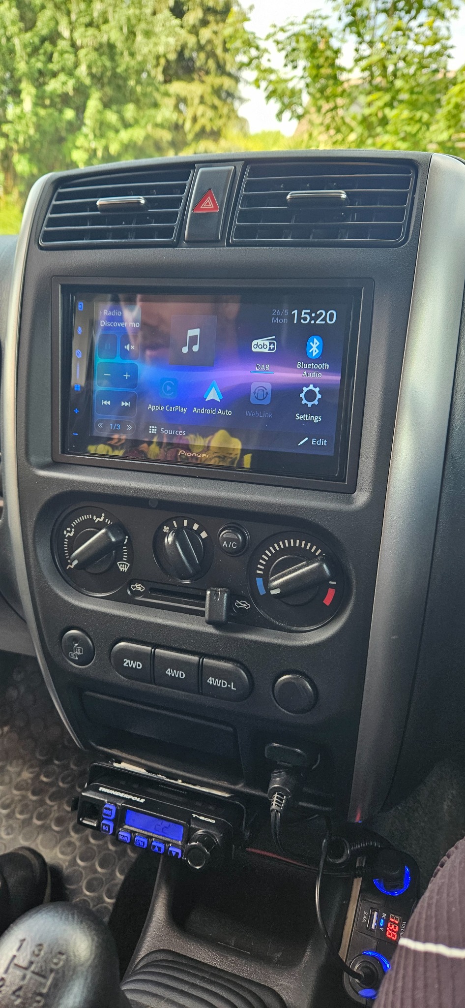

Now it's just a case of putting everything back together, I did start her up at this point to make sure all the wiring was correct before screwing everything back in. The new unit should go back in easily if you are utilising the original carrier. The Pioneer came with black plastic surround, but this wasn't needed with the new facia. The clips for the facia can be a bit fiddly to get back in and i'm glad none snapped in the process. But if they do you can get some quite cheap on eBay.
And there you have it!

How does this or other new head units with android auto and its own GPS actually work?
Can you run a navigation app on them and still use the phone for other stuff at the same time now?
Are the head units a stand alone thing now and not only the chinese android units?
I now use the old head unit only for BT music from my phone.
And navigation apps on the phone screen.
