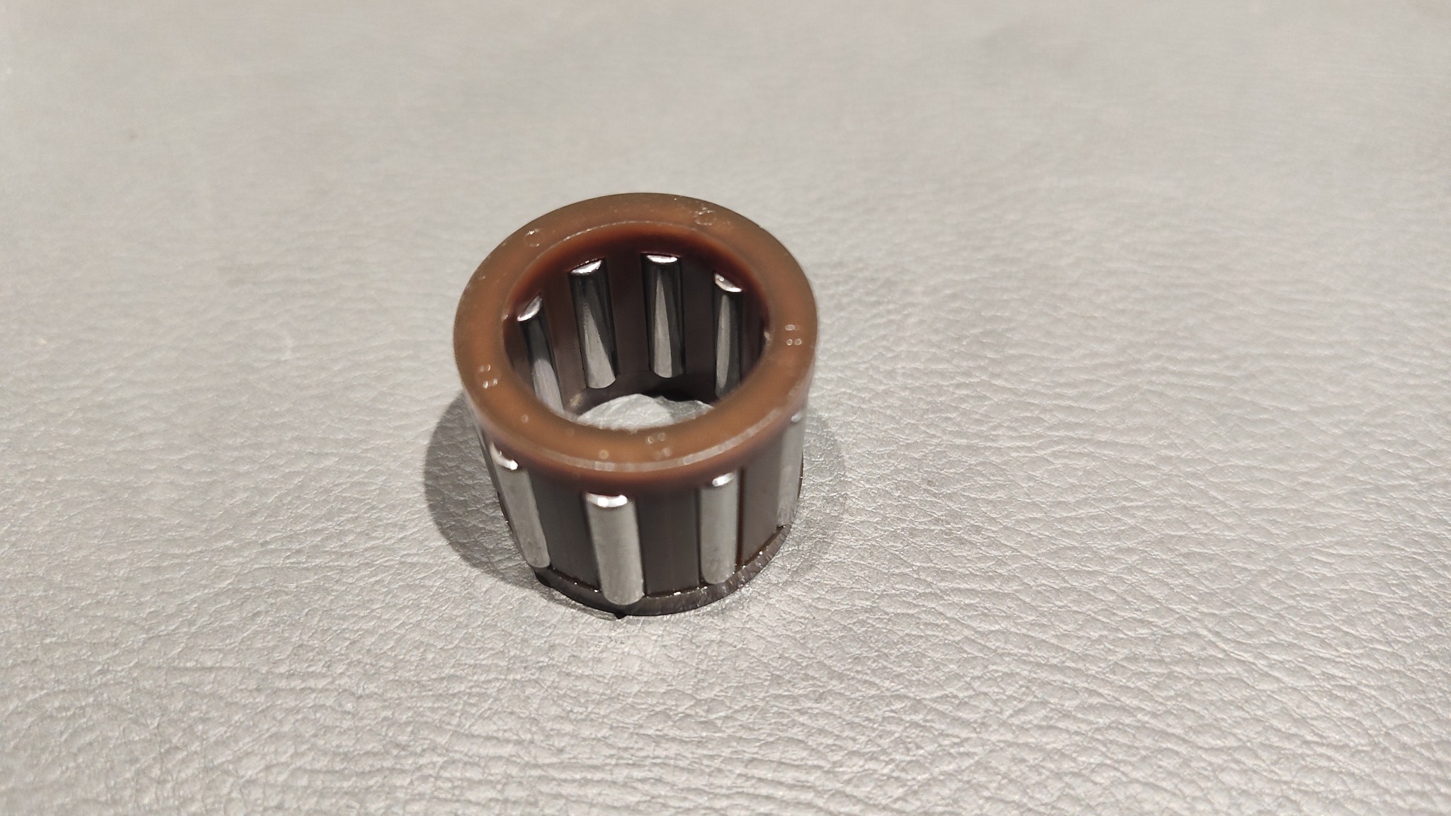

Finally got the transfer case back in the car after fine checking bearing play and the rest of the case and changing the 2 bearings that had any play in them.
Still no change. So then it must be the gears themselves that make the noise. They make a whine anyway so noise when doing a re-gearing to lower the ratios is unavoidable. Guess I'll have to live with the noises and as they haven't gotten significantly worse over 50000km I guess there is no immediate danger of it breaking down.
Looking back at my history I see that I senced that the only thing that helped a bit for the noise was to swap the worn chain for a new one. But once the chain was run-in for the after market gears the noise was back.
This, and how there is no noise with an original geared case, says to me that the chain sprockets is the culprit in the Trail gear kit.
I guess I would not recommend this kit unless you really need it having 235's or bigger tyres.
Having used the car now for a few months with the original gearing I think it would cope with the 235's if you have a 1.6 and carry little or no load, and do little or no offroading. Clutch was smelly at times doing mountain overpasses with load wich no not happen with a bit lower gears.
I think that 235's on a stock gearing and stock engine is boring. Make a very powerless car with a too high low range.
Might consider doing all the axle/diff/gearbox swaps needed to make a SJ/sammy transfer fit on a '05 or newer, if I had a donor a car or a thicker wallet.

Just out of interest how cataclysmicly loud are these gears? Obviously enough for you to think it needed looking at but annoying, unpleasant or painful? I ask as I keep getting drawn to their 15/104 set for the automatic which I want with 235s to take the top end out the autos gearing.
