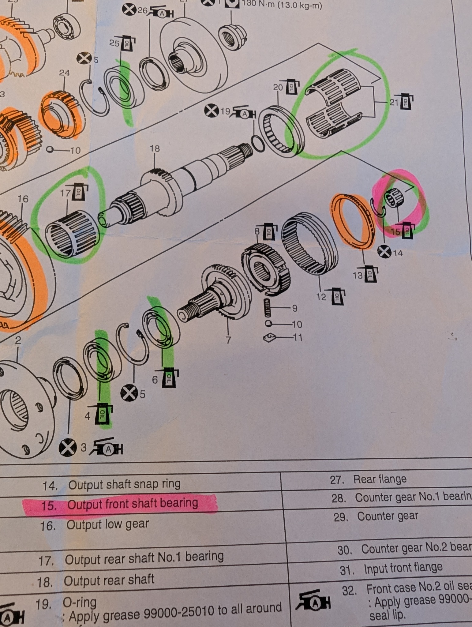

Opened the case during christmas and inspected the bearings. Some show slight signs of wear but nothing alarming with just barely any clearance. Only one needle bearing is too bad for me to put back in and some of the ball bearings has a very slight clearence and can be swapped just because I am at it. They all roll just fine.
The one needle bearing with some play can be the culprit to make the box make some noise but I am having difficulty sourcing it. Not much luck (yet) doing google and searching SKF and acc to my Suzuki dealer they are not in stock in the original suzuki warehouses so not possible to order sadly.
My options:
1. Put it back together and live with the noise until it breaks. Still got an extra case for spares.
2. Put all the low gears into my well functioning new to me used extra case and hope the noise stays in the old case.
3. Try to rework the gear wheels or shafts to fit an upsized needle bearing or try to make a bearing fit that i can source.
4. Change the diff gears, make a cradle, make a drive shaft and alot more to try to fit my 4.16 SJ low geared transfer case. (no, it is not a real option)
It is the needle bearing marked in pink no 15 I would really like to swap before putting back in.
But since I am at it, all bearings at the main / output shaft can be swapped just because, if I could source them.

Replied by mlines on topic Jimny Gen3 low geared transfer case, push button.
Whats your VIN number (PM me if you want)
I can see the needle bearing in the listings I have but the other parts on the end of the same shaft are different to your picture
09 Jan 2025 22:57 - 09 Jan 2025 22:59 #259037
Replied by yakuza on topic Jimny Gen3 low geared transfer case, push button.
I was sure I got the right service manual?
This is how my case look inside.

10 Jan 2025 08:51 - 10 Jan 2025 11:20 #259043
Part is £25 which probably equates to 10,000,000 Norwegian Krone
plus import duties to Norway (15,000,000 Krone) and postage to a supermarket in Norway that is nowhere near your home
10 -15 days lead time as it is in 3rd level depot.
