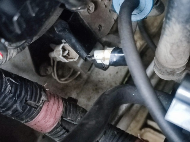

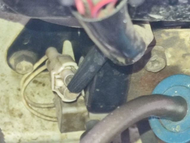

I have seen on Youtube and in the BigJimny Wiki that I have to short-circuit this connector:
So I have tried this way, right??

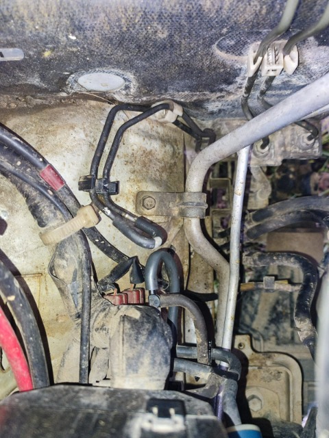

And I have also looped these vacuum tubes:
I have also tried to only stop the tube that is marked with a white stripe (the one that in the Wiki is marked for locking the hubs, going to the second solenoid VSV2), according to this post . The author says he has no leaking pipes, mine are clogged, so I shouldn't have any leak as well, right? Whatever I try, I always get a flashing light error, both lights flashing!

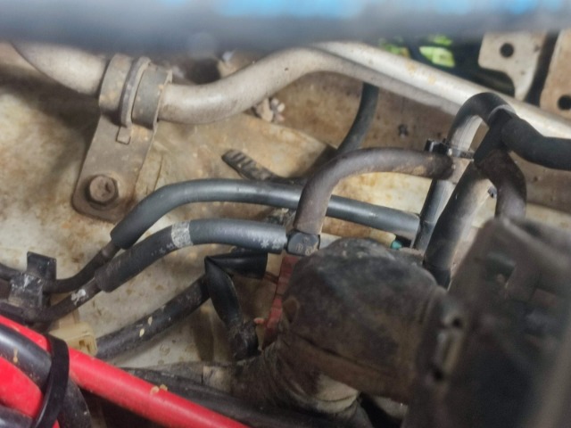

The only way I can get only one light flashing is without short-circuiting the connector, and having the pipes like they are:
How can I stop both lights from flashing? I am going to fit the manual hubs but first I would like to know how to solve this issue.

Once you have linked the wires in the vacuum switch connector it shouldn't matter what you do with the vacuum hoses, but leaving them looped or blocked is the best option.
