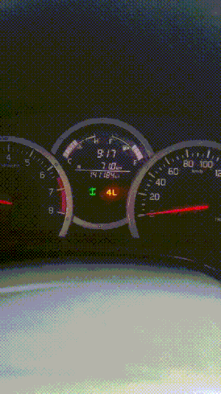

4WD and 4WD-L lights start flashing randomly when driving in 2WD mode. They may keep flashing for half an hour, then stop, and then again. It doesn't matter if I'm moving or stalling.
Both 4WD and 4WD-low modes are working as they are supposed to. I have found no driving defects, except for the lights that keep flashing with the pattern in this video.
The mechanic checked for vacuum leaks and found nothing.
The electrician checked the 4WD module signal and made me change both switches in the transfer box, part 37630-76J20.
I have had these lights flashing for more than 5000 km and four months. Could you help me? What can I check now?
