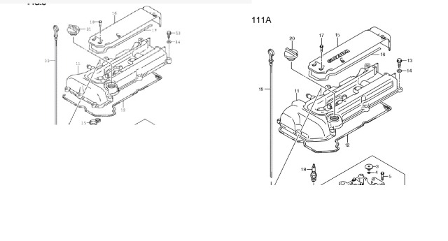

I have a 2001 Jimny which I believe is Non-VVT - daft question, but is there any way to tell if it is a VVT engine or not?
I am on the lookout for a replacement engine - ideally something with a bit more power - but trying to find something that will fit is a bit of a job!
10 Jul 2024 11:01 - 10 Jul 2024 11:03 #256717 by fordem
Replied by fordem on topic engine swap
The shape of the cylinder head/valve cover - the VVT engines have a pronounced nose to house the cam synchronizer - the engine on the right in the image above is VVT.

10 Jul 2024 11:40 #256720 by Busta
Replied by Busta on topic engine swap
Also VVT engines weren't fitted to Jimnys until 2005.
10 Jul 2024 12:39 #256723 by CB1289
Replied by CB1289 on topic engine swap
ok cheers guys - having looked, i can confirm it is a 1.3 Non-VVT in my Jimny.
If i were to look for an engine with a bit more power would i need to find a M16A Non-VVT? Are there any other options for me that people are aware of?
