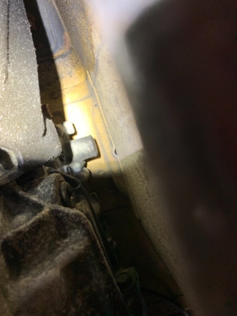

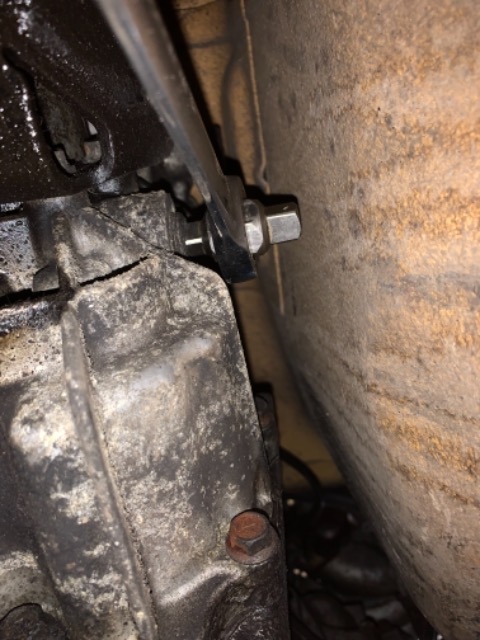

X8GGY wrote: I use one of these with a ratchet spanner...
I’ve just used this method as well as no room for a socket set.
Definitely 10mm

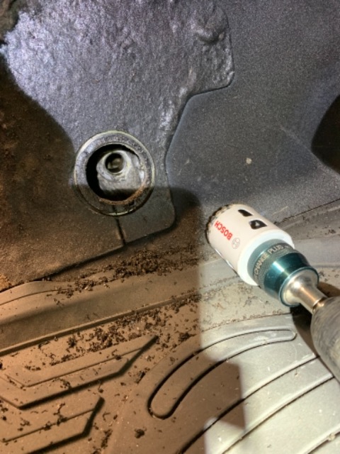

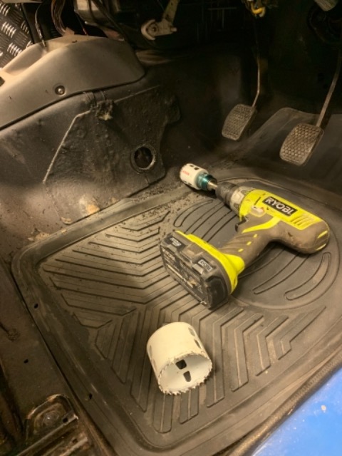

I've had a look this morning... on my old X reg Jimny Boogie...
the gearbox filler is on the drivers side! LOL :lol:
Slightly different?!
  • X8GGY
11 Apr 2021 10:09 #234394 by X8GGY
Replied by X8GGY on topic Gearbox filler
  • X8GGY
11 Apr 2021 10:30 - 11 Apr 2021 17:06 #234395 by X8GGY
In  fact... about, here -
The bigger holesaw was just used to cut through the sound-deadening material, so that it could be scraped off -
B)
