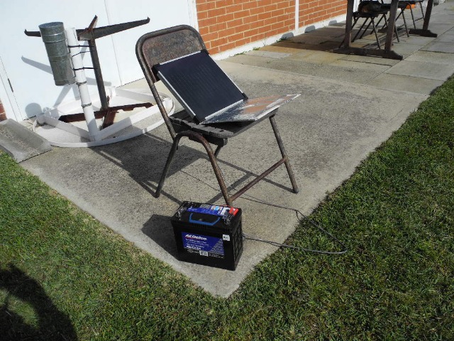

17 Oct 2020 01:10 - 17 Oct 2020 03:56 #229189
by GeorgeC
Replied by GeorgeC on topic Re:Gen 4 Battery swap
It's Saturday Morning again and FiFi, the Cat, is patiently waiting for me to move the chair into the sun and bring out the Solar Panel. Then I remembered "Lightning", he will be wondering what's happening today in The Sunburnt Country. Well, this week nothing! I'm now letting the EFB battery rest on the bench for 4 weeks to observe it's resting voltage. It will go on the 240V charger after that time. As for the Cat, she is spending the day under the table, sleeping on the chair, just like last week (see photo).
Cheers all, George.
