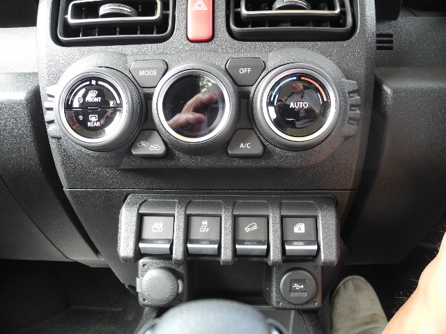

mlines wrote: George appears to have an electrical load management issue possibly due to a wiring fault (earth) combined with his driving profile.
He makes very short trips with full electrical and electro-mechanical (aircon) load. Perth Australia is hot!
The vehicle appears to react to this load by commanding the alternator to reduce volts to lighten the load on the engine, this is the normal function of the LIM circuit on the alternator.
As the journey is short, the battery never gets charged and eventually discharges completely.
As no-one else reports this, there is likely to be some sort of fault that encourages the load sensing on the battery to limit the alternator more than it does on other Jimnys
The interim "cure" is to press the OFF button on the AirCon that disengages the aircon compressor clutch. This reduces the engine load and allows the alternator to start charging the battery as the engine can now provide the energy.
This is what George means by turning the alternator on/off, he is referring to the aircon clutch which has this effect.
Update time:
I don't always catch the full meaning the first time I hear and or read something, there is always a deeper message I miss.
For the OFF Button to enable the "fix", the car needs to be stopped, probably in Park, everything off, just as the RAC Man demonstrated.
Trying to drive home with the "fix" enabled did not work, as the resting voltage shows, only 12.6V.
There are many electrical loads that restore the normal alternator features, smart charging, as you drive.
Pages 6-42, 43 in the Manual shows the fuse values for many loads that may be switching off the alternator as I drive. The Power Steering and Thermo Fan, both 40A fuses, for example.
I have read in this forum of Gen4 owners charging the battery for 10 minutes in the driveway during lockdown. I can now see how that could be done, by using the "OFF" switch.
I don't see this as a 'daily drivable' solution. A pre-drive warm up may restore some of the starting energy. Using the off button at red lights may also help a little. :(

Monday: A 10 minute warm up, clean the windows, all with the "OFF" button depressed. I then drove to the shops carefully managing the load. I checked the voltage on parking with the engine still running, the mid 12Vs was it! On arrival home with the engine still running, the best was mid 13Vs! No 14-point-anything volts and that's with the "OFF" button depressed and the engine running!
I have to accept the RAC Man is right, the Smart Controller would eventually fail and this event seems to be getting closer with each drive! :(
