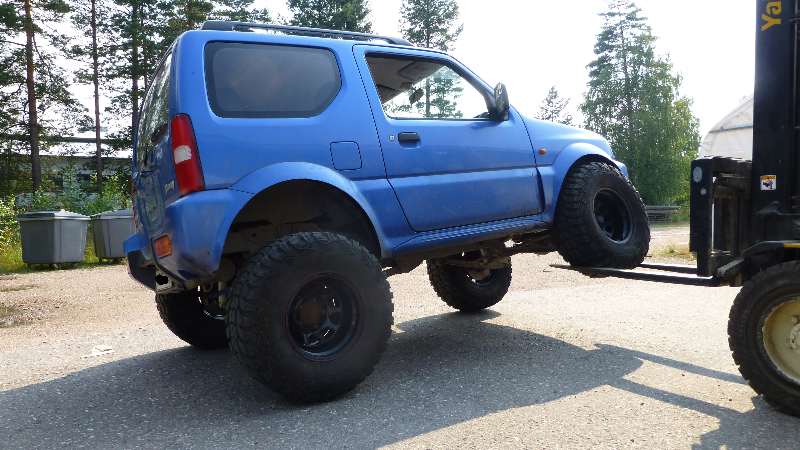

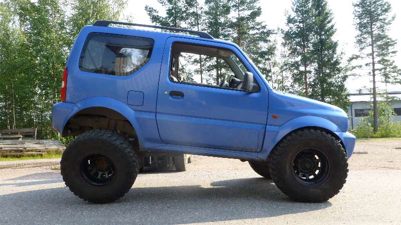

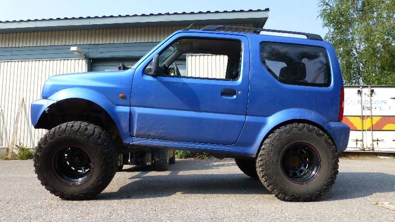

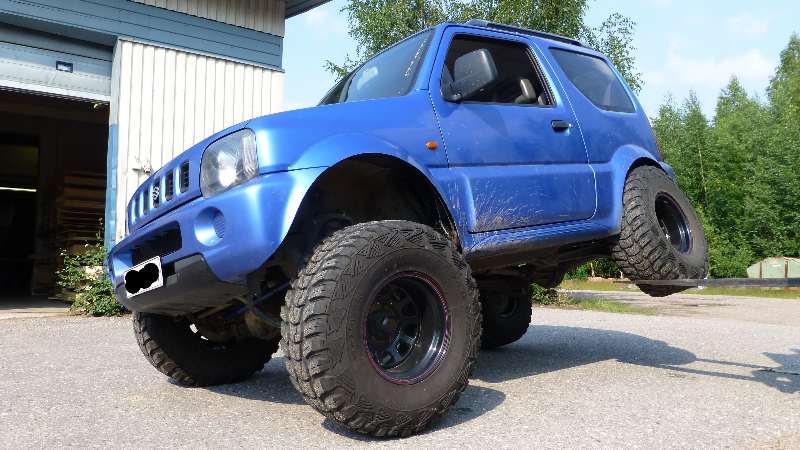

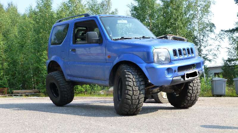

Today we did some flex tests. And with anti roll bar connected, we managed to get front tires rub slightly on the bumper, so a little more trimming is needed, but no other issues whatsoever!
That's with those tires, but if I had some boggers or similar aggressive tires, I would have to show some more hammer to foot wells, but again just some minor adjusting...
BUT when I tried disconnecting the anti roll bar, there was a little bit too much travel in at front, so in order to drive offroad without the a-r bar I need to limit travel in, but just very slightly. Also it became apparent that it's gonna be impossible to have "barrel flex" with stock radius arms, so I will swap them for some longer ones.
The anti roll bar is connected in every picture.
"Only" some 15" to barrel flex! :laugh:
No problems with rear tires.
About the same articulation when lifting a rear tire.
I need to limit the front in travel to what it is in this pic.
And yes, I did also tests with different wheel angles too.
Modifying a Jimny is almost too easy for a guy that's been playing with SJ's and Samurai's for many years, LOL!
