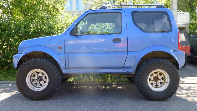

Paul4x4 wrote: Just switched to 10" wheels. What do you think?
Some minor hammer work was needed to make room for them, but now there's no rubbing against anything when driving on road.
Next job is flex test, and after that's been sorted out, I'm gonna install some rubber fender flaps along the arches, because those tires stick out a good amount! :laugh:

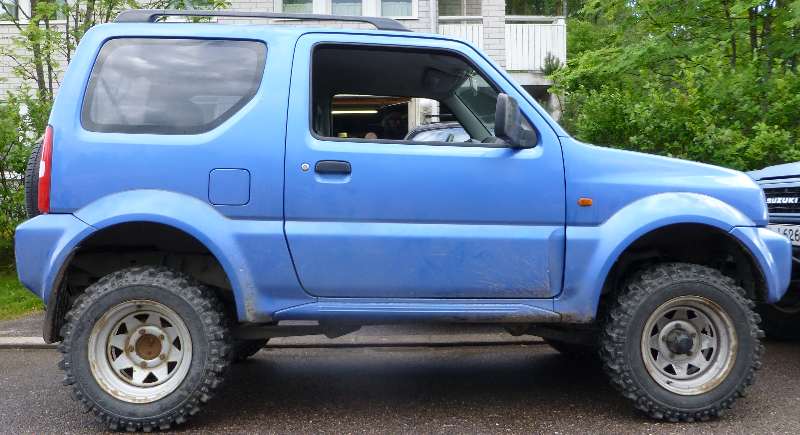

Here's a reference pic of mine. I took this while I was swapping the 8" wheels to 10" ones. 8" at the rear, and wider one up front. Easy to see how much more the tire sticks out with the wider wheel.

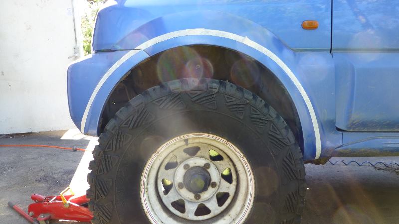

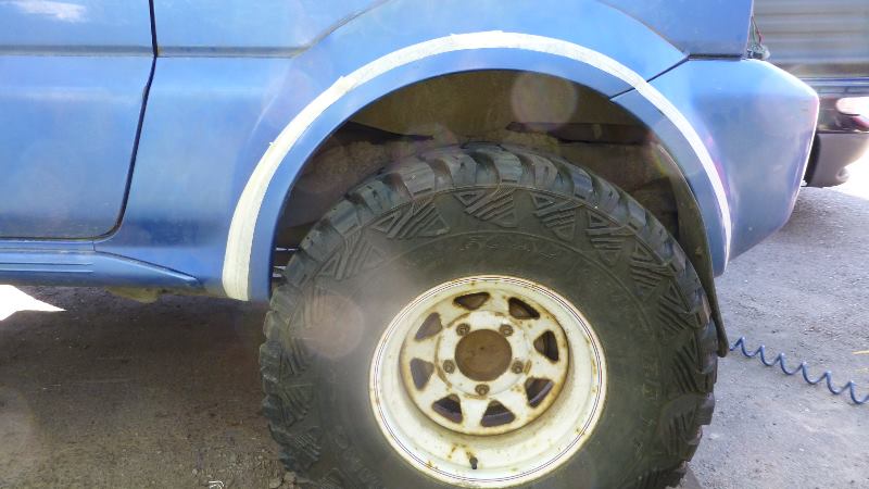

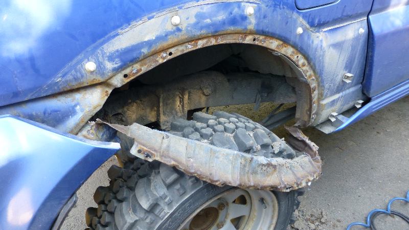

Then just start fitting the tires, and you can see where you have to start cutting and hammering! I first bolted the tires under the truck, and marked the cut lines with tape like this.
After you have cut the plastics, it's easy to see what you have to do to sheet metals. Inner arches need to go at the rear. Just carefully drill those spot welds, and rip the thing off!
Front fenders need some cutting too, but a pair of sheet metal shears will take care of that in no time!

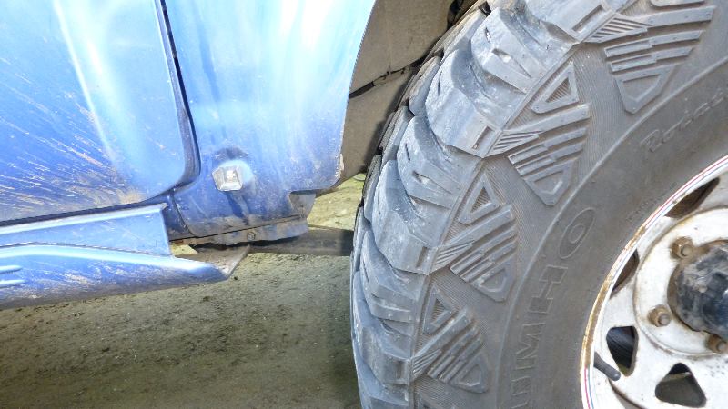

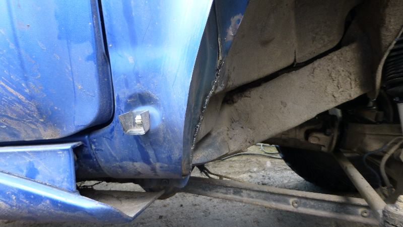

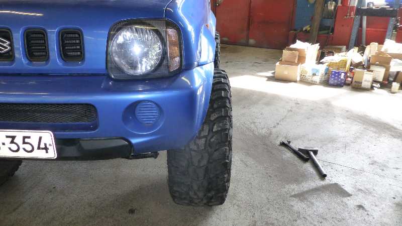

Before:
After:
I have used an angle grinder to cut a small piece off, and then welded it back together. After that(what isn't done yet in the pic) you need to hammer that edge where all the sheet metals come together level with the inner arch and you're done! Then you can start testing how the tires have room to turn in there, and if they catch still, use a BIG hammer to smash those corners in some more, and repeat as long as there's enough room! :laugh:
Finished product! Time for test driving, and after that some more hammering if needed!
