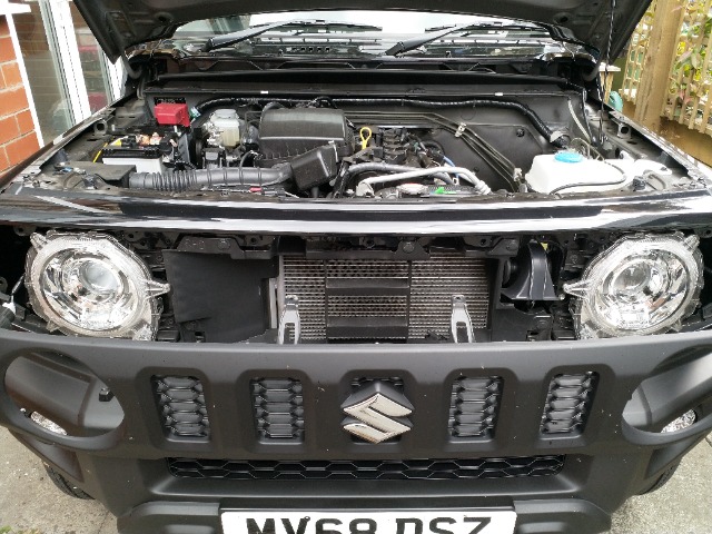

Have you removed the 2 plastic push rivets that go to the top of the radiator housing?

There is just enough room to mount the horns in front of the blanking plate adjacent to the off-side headlamp but the pump needs to go inside the engine bay alongside the rad. on the off-side. The standard wiring is not up to the load of the pump so you need to fit a 30 amp relay, activated by the standard horn wiring and feed directly from the battery.
Soeley's picture appears to show a different horn to my original unit so maybe he has a different solution.
Roger
Roger

Yes, that is a Stebel Naughtilus I already had. I had to split the trumpet from the compressor though to fit it there.
