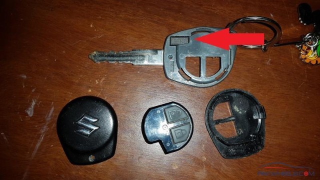

Yakuza, when you say "you will need the correct immo chips to program it to your car", what do you exactly mean?
If the vehicle has an immobilizer, and if you get a replacement original key with 2 remote locking buttons integrated into it, does such a key already have the immobilizer chip?
Can this Chinese device reprogram such a second-hand key to another Jimny from the one to which it was originally programmed?
01 Dec 2018 21:38 - 01 Dec 2018 21:39 #198507 by Jezz
Replied by Jezz on topic KEY PROGRAMMING
The imobilizer chip is separate to the lock unlock electronics
It's been fettled just a tad.
Last edit: 01 Dec 2018 21:39 by Jezz. Reason: spelling
02 Dec 2018 09:38 #198517 by Bosanek
Replied by Bosanek on topic KEY PROGRAMMING
A picture says a thousand words.
Is the metal key blade easily replaceable in that particular picture?
