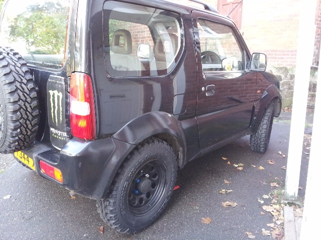

Hello gurus,
I have recently installed a 2" trailmaster lift and just got a set of 215/75/R15 General Grabber AT3s fitted this afternoon (2004 Jimny). I'm running 7.5" wide steel wheels and from reading this thread it seemed the jury was out on whether the 215s might scrub or not.
Unfortunately, pulling into the petrol station on my way back from the garage I went over a very minor dip in the road and both front tyres scrubbed
If I replace my wide wheels with stock steelies will this solve my problems? And will the 215s fit the wheels fine? Where is it on the arch that the scrubbing usually happens? These things never go smoothly haha!
Thanks in advance!

Replied by jackonlyjack on topic Tyre Sizes - Rough Guide Thread
Yes the tyres will fit standard wheels
as for where yours are rubbing just let them catch a few more times
and it will become evident
then make a decision to trim or not
Jack
Jack

Replied by Riccy on topic Tyre Sizes - Rough Guide Thread
go for Dan's trim look
