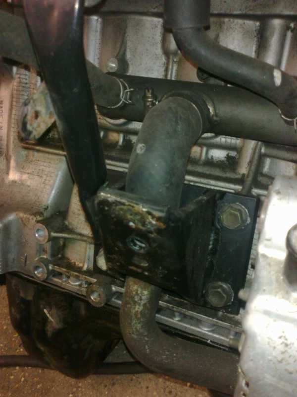

Her you go this is the drivers side mount i fabed up

looks good, i was looking at adapting the mounting holes on the chassis but looking at yours i may try your way, i will wait till i dry fit the 1.6 block (bolt to gearbox but leave block hanging from engine hoist) to gauge what needs doing

Defo thats what i did with no head on gives you real good access total toss pot once the manifolds are in place

tell me about it, i was out there tonite removing the intake manifold, come sat morning i will be removing the engine, fitting the new block making a mount, then swapping the parts over, all fun
