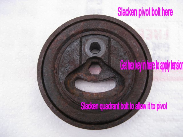

I'll have a look! If possible as I'm not great with these things! Any chance you could attach some photos to we're I need to be?

May just be belt tension needs adjustment. The main belt adjusts by pivoting the alternator, the power steeering belt by rotating the idler pulley.
