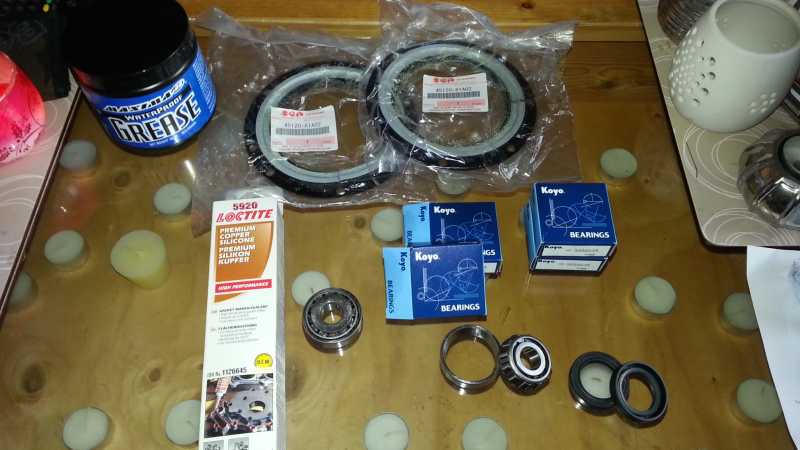

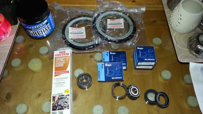

DELIVERY! Got all the bits I need now and a long weekend off from work to do it so hopefully all goes well. If not I'll be back on here in a flash lol ;)

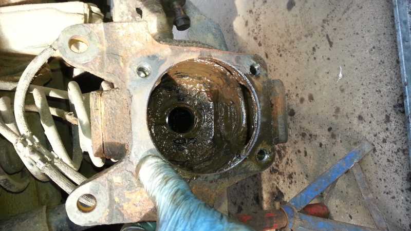

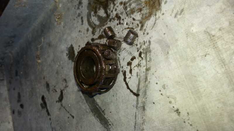

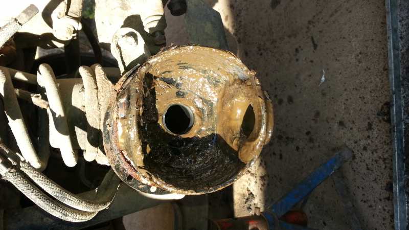

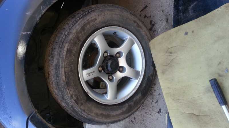

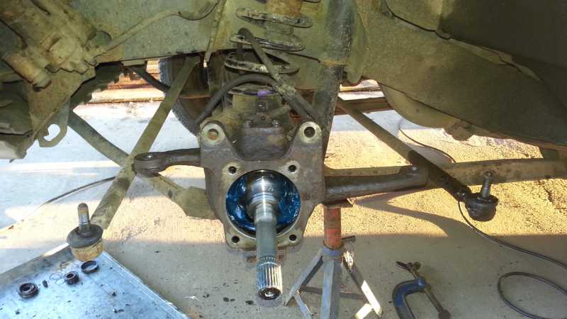

Well changing the king pin bearings was easier than I thought lol thanks to Martin for his webshop and how to guide and to everyone else that gave any advice. I have no wobble in either wheel and no leaks on the ball joint so job done :cheer:

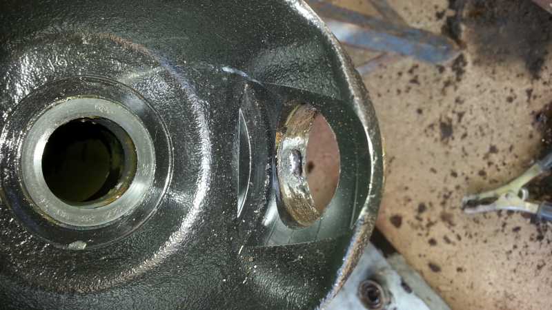

This was the bottom bearing on passenger side it just fell to bits :S
Welding a blob on really made it easy to punch out good tip :)
All clean and new seal and bearing races in.
Nearly there..
And finished passenger side. Took me almost as long to get that alloy clean as it did renewing everything lol

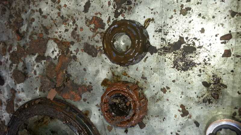

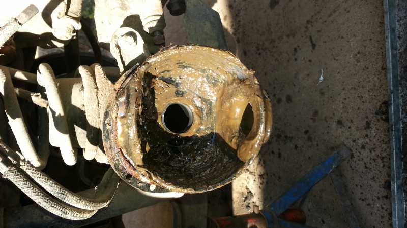

Drivers side hub was full of crap
The bottom bearing wouldn't even turn it was packed full of grit.
