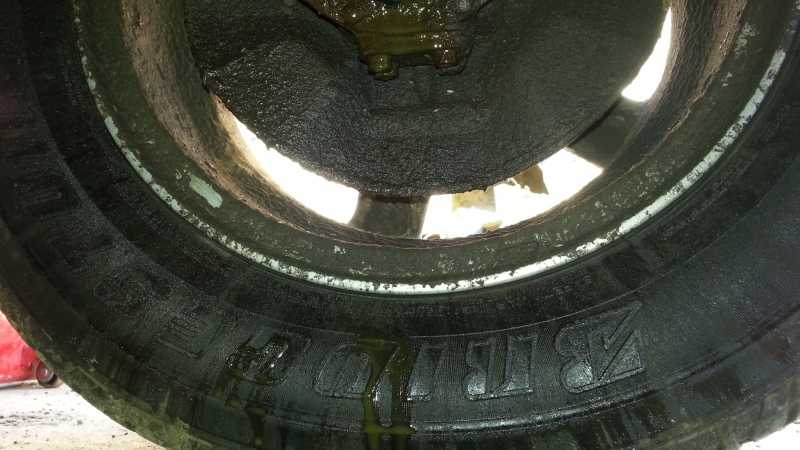

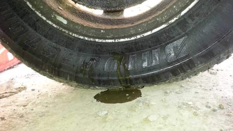

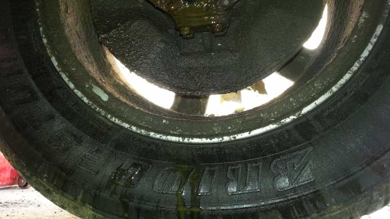

Ok so today I lifted up the front wheels and gave them a wiggle the drivers side was ok but I then noticed a small stream of oil pouring from the ball joint on the passenger side. So I had to put it back down. So im guessing that it was going to have a bit more play. I then thought I would top up all the oil I lost so tried to get the plug of the diff but it wasn't for budging one bit so I've soaked it in wd40 and will try again tomorrow.

never seen one that bad
if you jack it up on the trailing arm on that side it wont come out as the oil will run away from that side then wobble it
parts you may need are
a half shaft seal
top and bottom king pin bearings
a ball dust seal
sealent
lots and lot and lots of rags to clean it out with
and try and get some boat trailer wheel bearing grease

That was where I jacked it up from I see what you mean though only a bit should come out before it drains down to other side right?
