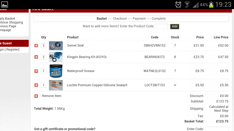

Would you recommend changing the swivel as you said it's not necessary and I could just clean up the old one? Although I'm thinking whilst I'm doing it I might as well make it all new.

27 Sep 2012 18:49 #48999
Replied by mlines on topic Oily ball joint on front axel.
Yes, that would do both ends of the axle.

27 Sep 2012 20:02 #49004
by Muzza904
Replied by Muzza904 on topic Oily ball joint on front axel.
Ok just got payed so just bought all the bits i need to repair the problem
Thanks also for the walkthrough martin that looks pretty helpfull the task ahead doesnt seem so daunting now lol
will re post when i have got it all apart and back together lol. thanks to all for the helpfull comments
