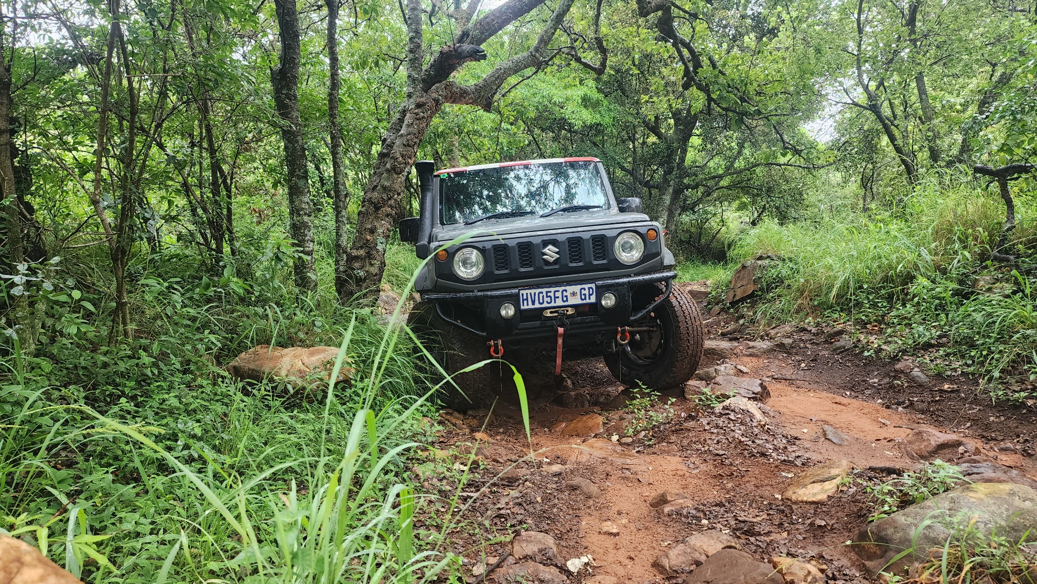

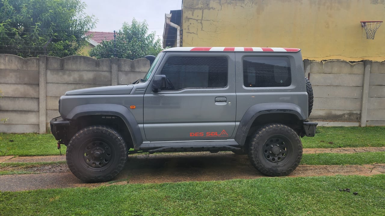

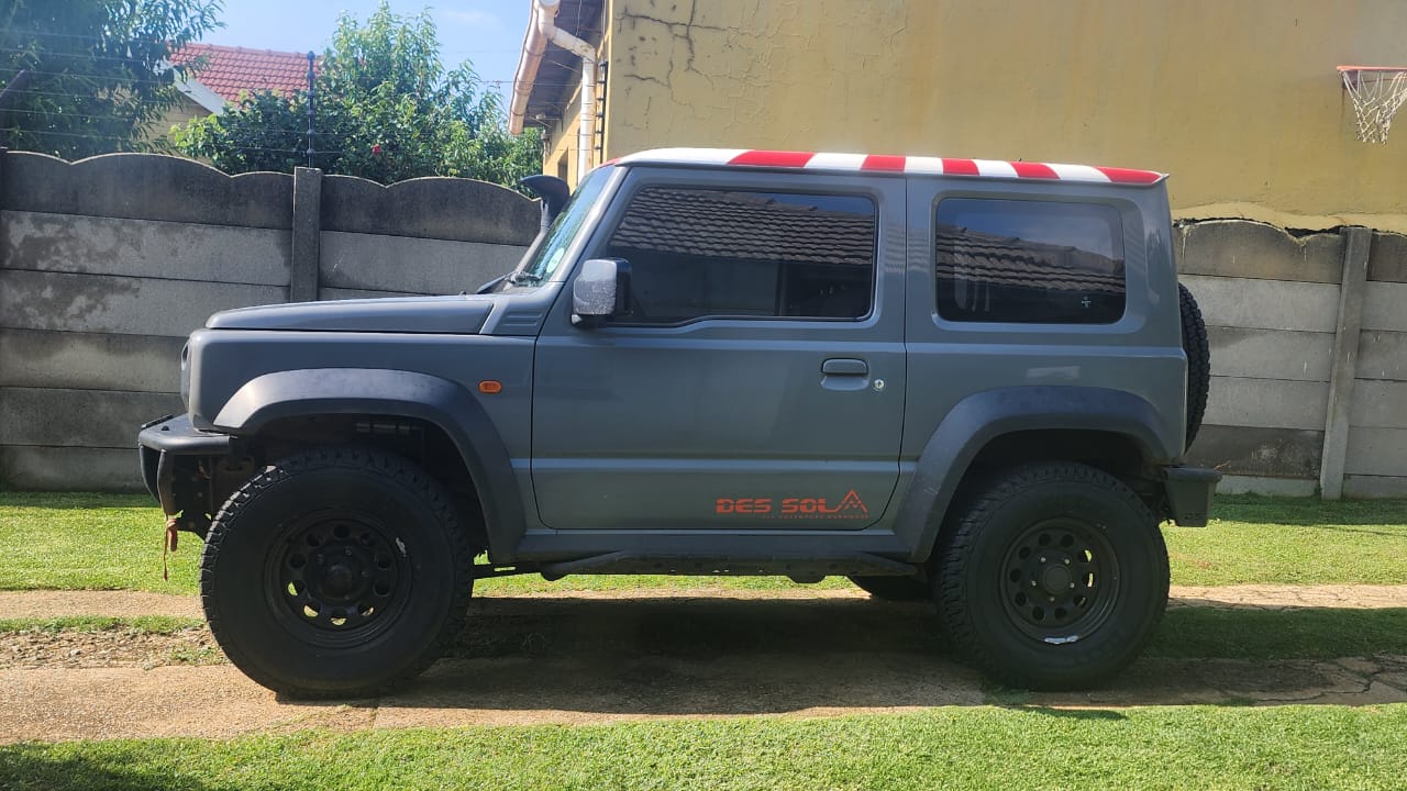

A little feedback.
On road, the auto now changes down earlier, seems to hunt less, i.e. it drops to third and stays there.
fuel consumption appears to be around the same.
Off-road they performed exceptionally well. I deflated to 0.5 bar and we tackled a track that I quite possibly would not have been able to complete with 235's. On one muddy climb my Gen 4 with A/T's faired better than the twin locked SJ on 31" muds.
I do need to either lift it further or fit extended bump stops. It scrapes the top of the arches on all 4 wheels.
