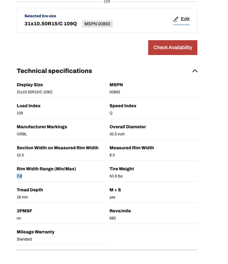

Certainly not saying don't do it. But probably worth noting that the rim range for a 31.10.50R15 is 7-9". So the stock 5.5" rim is well under spec.The current tyres are 235/75R15's. I intend running the new tyres on the stock rims.
