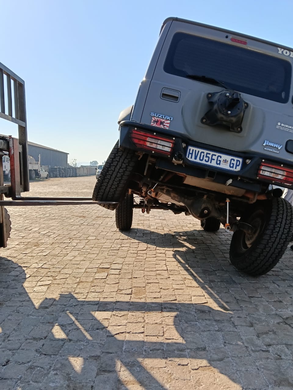

Some feedback after about 8 months.
The tyres are great on-road. Lots quieter than the M/T's and they actually have decent road holding.
Off-road, they rubbed on all for corners at the top of the arches, but I was able to conquer an obstacle that I couldn't do before the bigger tyres. That left me with a few options, I could just fit extended bump stops, a body lift or I could lift the suspension by another 25mm.
I opted for the 25mm lift. Des Sol, a local company that I have sourced most of my goodies, including the 50mm remote reservoir mono-tube shocks, was able to supply me with the parts I needed. They extended my shocks to 75mm and supplied extended bump stops, spring spacers, prop spacers and a new cross member.
I still need to test it off-road with the new lift.

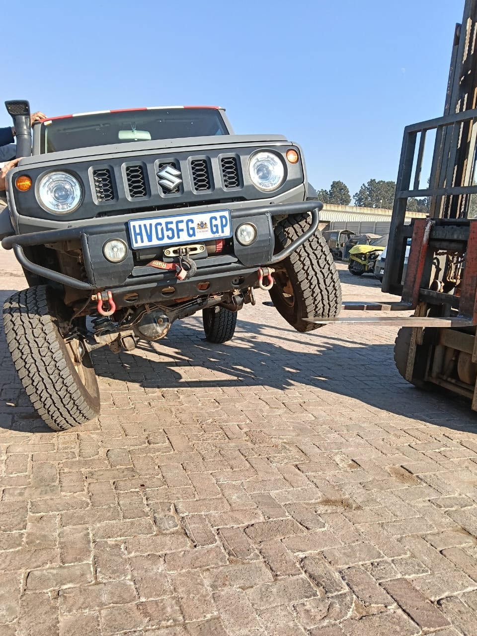

21 Aug 2026 16:30 #265128
Replied by Lambert on topic 31" tyres on a Gen 4
Impressive. What's that then like about 450 to 500mm under one tyre with the other 3 on the floor?
23 Aug 2026 16:14 #265144
by Gadget
Replied by Gadget on topic 31" tyres on a Gen 4
That's some serious articulation!
