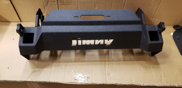

ahtr.... I have the same bumper as you with the "Jimny" cut outs....
But
I dont have the instructions. Do you ? If so please could you attach pics.
But

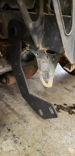

Missing a load of nuts and bolts as the box was quite damaged.
Hopefully that's all I'm missing.
Other dog leg bracket is on the car as below.

Replied by Reason2doubt on topic Chinese Steel Bumpers: Installation
Hi, sorry for rue late reply.
It did not link to the front cross member. it only links into the dog arm brackets that sit in the side of the chassis (in the circular holes). It sits ontop of the chassis rails at the front (no bolting directly to chassis at the front).
You can drill through the bottom winch plate (that links to the side of each dog arm) and attach it to the chassis via a bolt on either side but I never did. Any pressure applied to the bumper by a winch should pull it down onto the chassis and that will not bend easily.

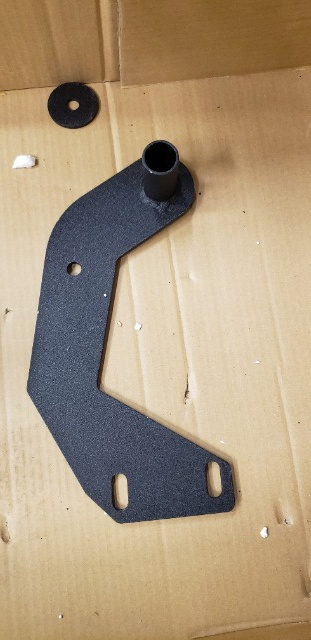

Missing a load of nuts and bolts from a torn open bag as the box was quite badly damaged.
1 Dog leg bracket is on the car
What are the brackets below for & where do they go ?
