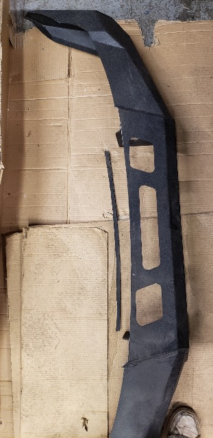

What the heck is wrong/different with my 1999 LHD soft top ?
After cutting 1/2" off the back side of the front bumper top the uprights now foul the leading edge of the lower spam panel. So more cutting needed to get it back enough for the corners to fit into the wheel arches.

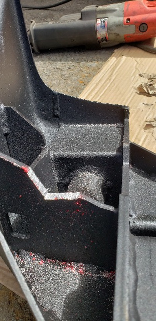

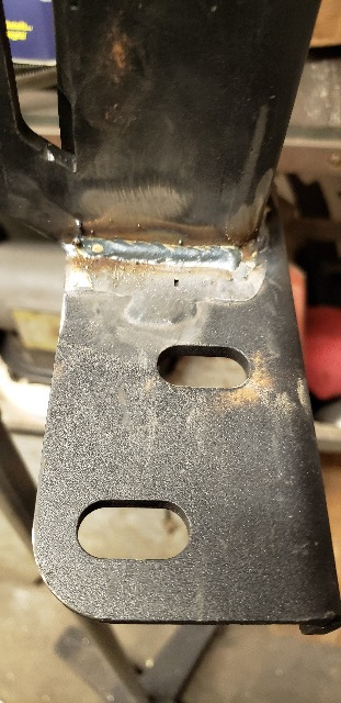

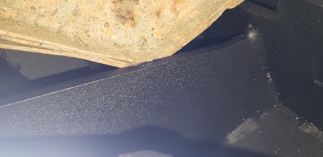

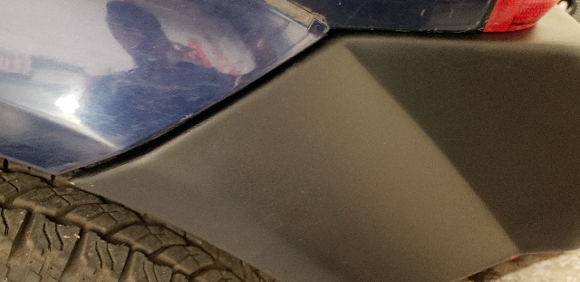

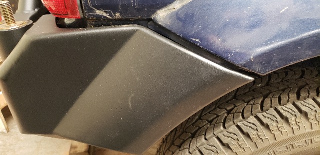

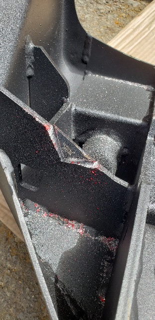

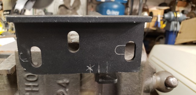

And then there's the rear bumper.....
The right side bracket lined up OK with the bumper but the left was out. So much so the bolts wouldn't go through.
The holes on the chassis bracket where the bumper holes overlapped were scribed.
There wasn't enough metal on the edge of the chassis bracket to extend the holes so the end plate was cut off and moved over 1/2"
So the left side finally fitted
But the right side was still out...
The reason... The corner strengthening plate for the spare carrier was hitting the corner of the body
Cut out a small piece of bumper and at last it fitted
