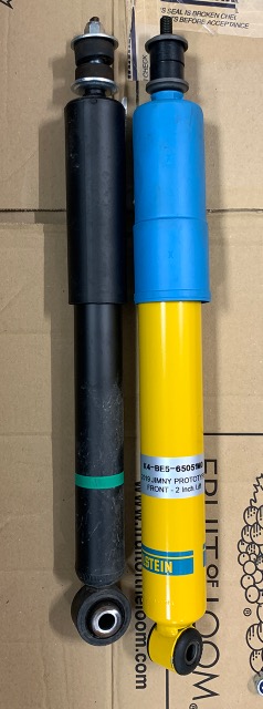

02 Apr 2020 16:32 #220587 by DAGZOOK
I've got an update from JIMNYSTYLE on the Bilstein H&R Lift kit - QUOTE:
"The complete kit will lift the Jimny by 40mm (this is the amount of lift we have measured on our Jimny after the suspension has settled), but the dampers themselves are 20mm longer than their OEM counterparts (please see attached a quick picture that we took during our install comparing an OEM front damper to one of our Bilstein front dampers side by side).
The H&R spring rates are aimed at Jimnys that are not excessively loaded. We have done the vast majority of our testing with 1-2 occupants in the car, as the primary purpose of the kit is to improve everyday drivability. We wanted to make sure that the kit was optimised for the 90% of driving that a lot of Jimny owners will be doing, as opposed to the rare occasions where it is treated to more extreme circumstances"
So this kit is aimed at complimenting the Gen.4 without crazy modification - It provides a modest 40mm lift (20mm additional droop + 20mm spring lift). As you can see from the photographs the Bilstein 'monotube' shock absorbers are a greater diameter over the OE allowing the shock to hold more oil and feature a much larger piston - so this shock should stand up to serious abuse both on and off road. The spring rates are being designed for a stock Jimny without excessive additional vehicle weight. Which is where other lift kits seem to fall down... (OME & Tough Dog).
