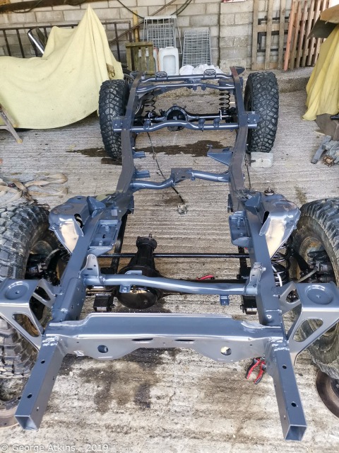

09 Feb 2020 18:58 #218240
Replied by jackonlyjack on topic Recommended suspension kit 2" for New Jimny?
Cross member is part of chassis
Fits from chassis legs across the middle.the prop runs over the top
I have not looked under a gen4 so i'm assuming it unbolts

- Grima
09 Feb 2020 19:18 #218241
by Grima
Replied by Grima on topic Recommended suspension kit 2" for New Jimny?
That's why I love this site, people with a life time of knowledge sharing with thick people like me a photo of a cross member would be most helpful.
