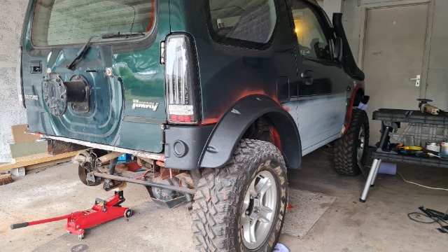

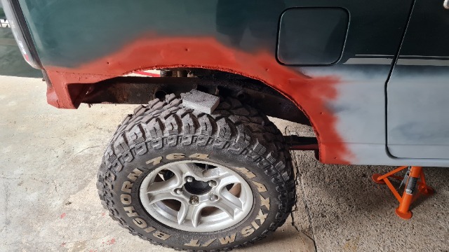

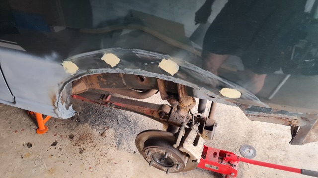

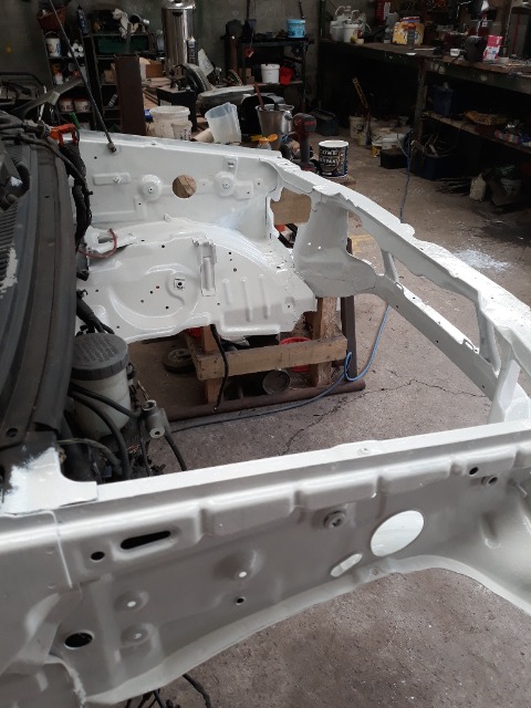

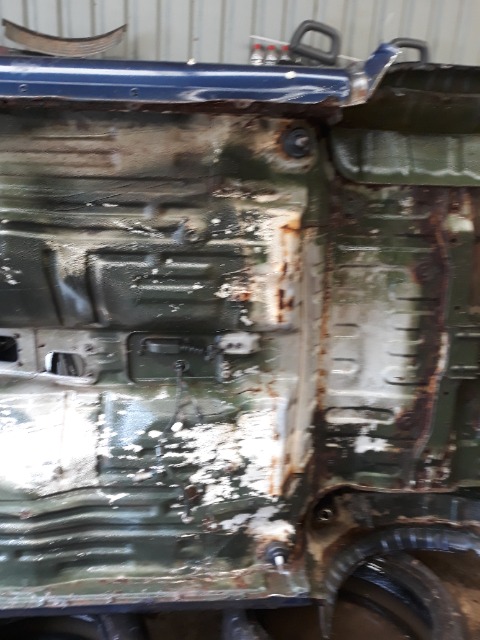

Today was a productive day. I sorted out the left-hand rear wheel arch which needed 8 patches (!) in the wheel arch itself and then welded around the outer edge. All ground back and then lathered in seam sealer - the nice thing about the arches I'm putting on is that it won't be in direct contact with any mud or water that gets slung off from the wheels. Welded the small squares where the original arches clip into and then filled them for sanding tomorrow.
Moved to the other side of the car and sanded the filler and gave it a quick spray of primer to protect it until raptor paint later in the month.
I was in contact with Keith to figure out the rear corner piece of the bumper and sometime later managed to cut it to fit and got it all screwed on.
Tomorrow I need to re-make the left rear body mount. I will see what I have time for after that! Much thanks to Keith again for his time answering my silly questions! I owe you a pint (or a few!).
