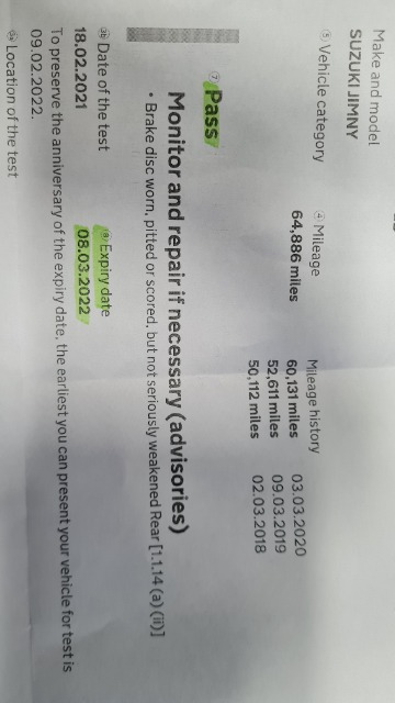

18 Feb 2021 16:59 - 18 Feb 2021 16:59 #232955
by Reason2doubt
Replied by Reason2doubt on topic What did you do to your jimny today?
Last edit: 18 Feb 2021 16:59 by Reason2doubt. Reason: Added photos
- Posts: 2339
- Thank you received: 672
18 Feb 2021 17:17 #232957
Good news, obviously that bit of Italian welding you had done last year was done well.
That is rear discs brakes for you, nothing but trouble. I find now that discs need replacing with pads, or more frequently if you let the vehicle stand for a while.
If I park up my other vehicle for any length of time, I don't apply the hand brake, just leave it in gear, otherwise the rear brakes stick, it eats discs, I did the last lot myself and saved a few quid.
- Reason2doubt
18 Feb 2021 17:29 #232959
by Reason2doubt
Thanks Doc! I am happy I took the time to 'rust proof' all that welding with multiple loads of paint too. I'm looking forward to getting under it again this summer for a quick sort.
Good to know about the rear disks and the handbrake. I'm able to park it without the handbrake on (live and go to work on flat ground)...so that's what I'll start and do!
