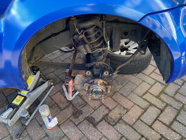

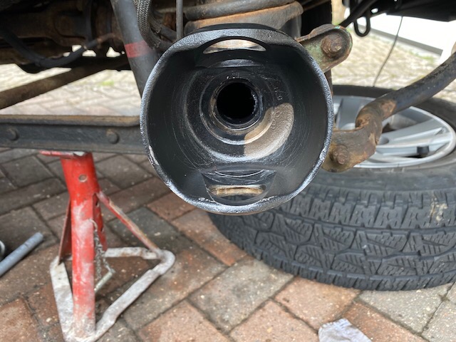

Kingpin bearings part 2.
It took me all morning to clean everything up, the hub was rusty near the swivel seal, so the face was completely de-rusted and cleaned. I also cleaned out the kingpin holders and cleaned all of the threads to make sure it comes apart again.
The only real problem with the rebuild, getting the bearing otters to go in the swivel, a bit of wet and dry, lots of copper grease and my largest hammer eventually persuaded them to go in. The circlip wasn’t easy to get on, the drive shaft didn’t come far enough through the bearing, so had to use a puller on the shaft.
The rest was straight forward, it just took most of the afternoon, but at least I know it is done well.
The test drive, no wobble in the steering wheel at all at 48-50mph, a slight wobble at 55mph, but only noticeable if you take your hands off the wheel, so all in all very pleasing.
My guess is the other side will need doing soon, but at least I know what to expect, everything will be seized.
Before the hub came off
The cleaned swivel joint
