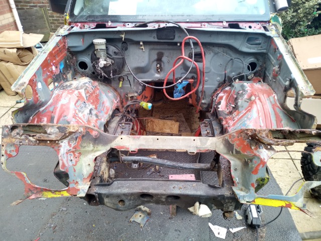

- Sick Nick
11 Jan 2021 22:20 #231714
by Sick Nick
Replied by Sick Nick on topic What did you do to your jimny today?
That looks like a fun game!!!
