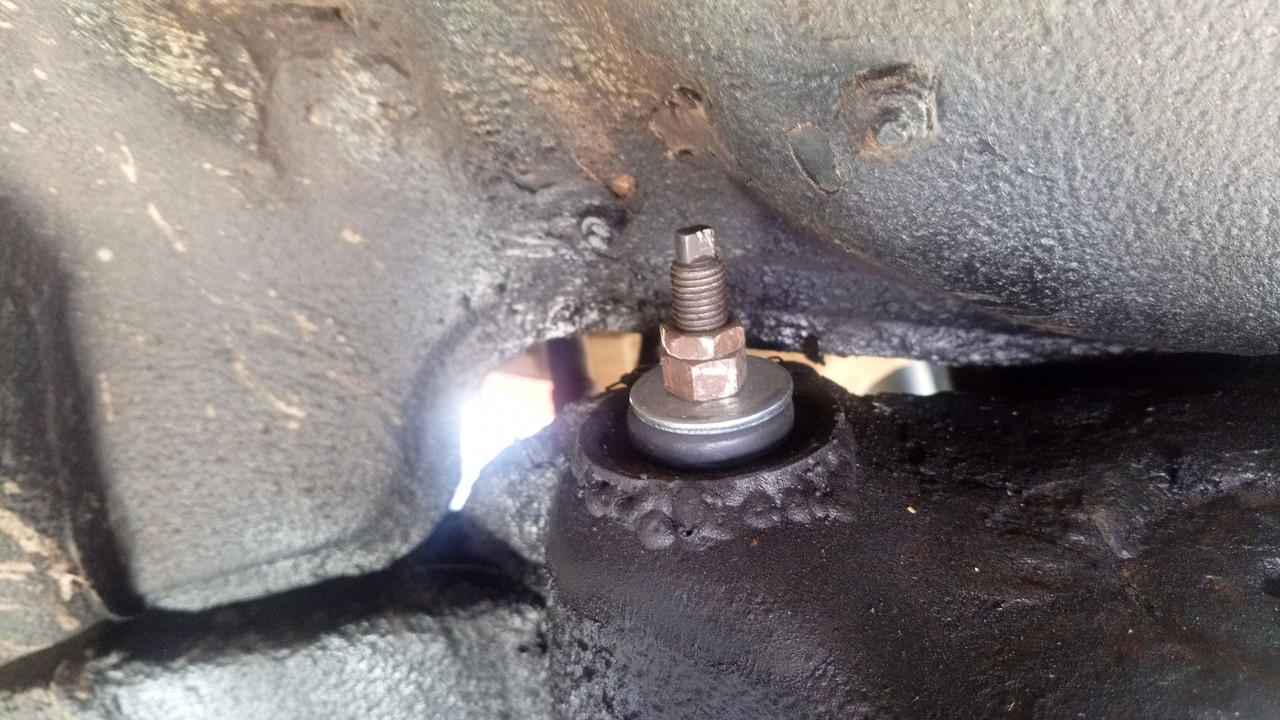

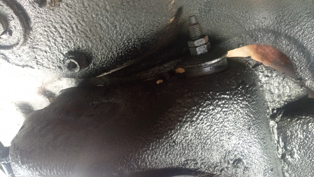

Got my front shocks fixed by a nice Italian garage.
Problem: Shock bust through its housing on a very badly potholed road in Italy travelling about 90-110km/h!
Solution was to weld top and bottom up using some fabricated steel 'washers'. The shock bushes and cones were destroyed but the shock itself was still OK. The mechanic used a pair of normal washers and some suspension bushes from a fiat 500. He even gave me some spare bushes for the future knowing I would have to return to GB at some point. The Jimny is a little bit Italian now!
I also got the other side checked over and it was found to also be a bit weakened so it received similar treatment:

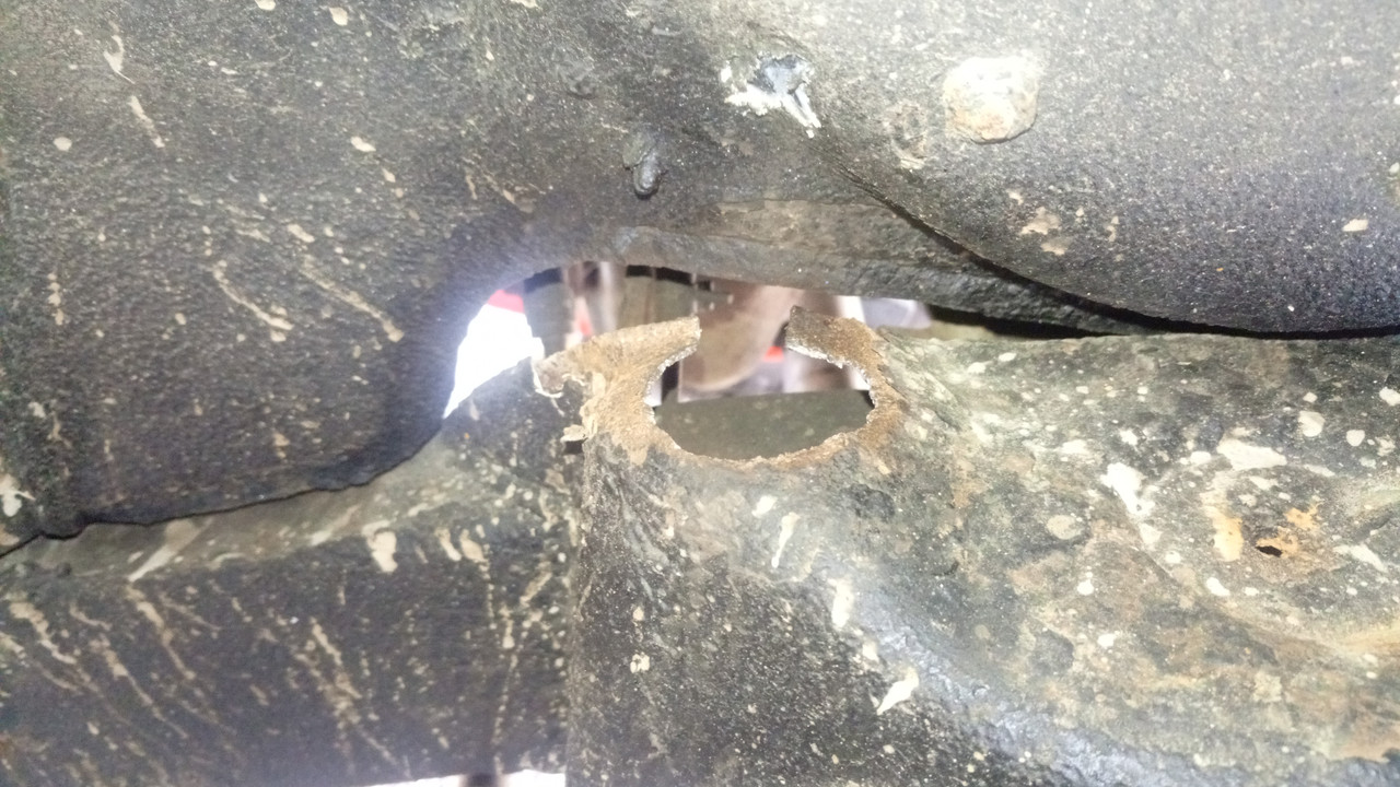

Bust the other front shock mount, this time on the Axle - seems to have twisted off...
Back into a different little local mechanic in Italy. Bloody roads here are proving too much for the aged metal on the underside of my car...

Shock mount reinforced by local garage. Turns out they are extremely familiar with Suzuki's - the owner and both mechanics used to race Suzuki Samurai's, Jimny's and Mitshubishi Pajeros around the world in various rallies.
He said it was a very common place for them to fail - I tend to agree as every point of contact on the front shocks (top or bottom) has had work on them!
Here's it getting put back together after having 6mm metal welded onto the bracket:
