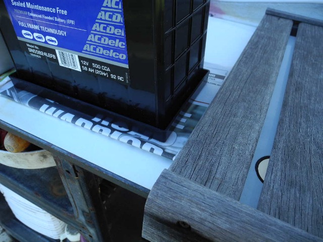

The new battery is the same height as the original to the top of the terminals
The Battery sits on the plastic tray with about 4mm of total space at the end and the side.
Sorry for the half-shade photo, the battery is now fitted, all good!
Replied by GeorgeC on topic What did you do to your jimny today?

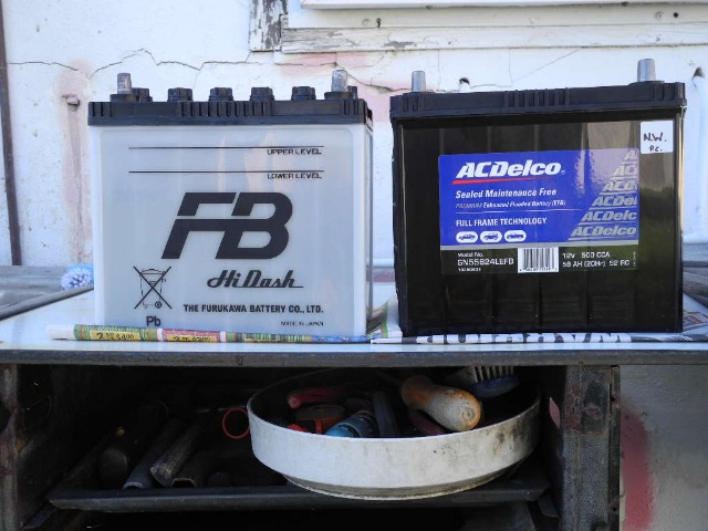

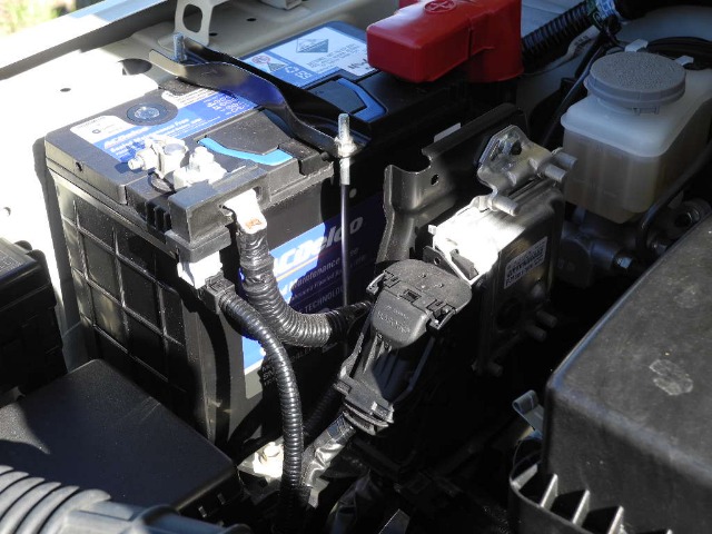

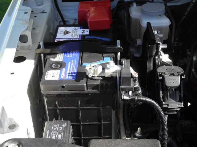

Fitted the new Battery!
This post follows on from: www.bigjimny.com/index.php/forum/6-jimny...ay?start=1296#224703

Looks good George, looks like it grew there. The benefits may take a little while to show themselves. Chris

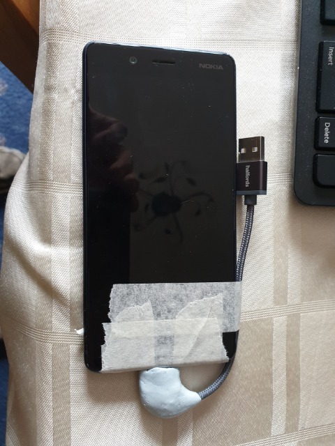

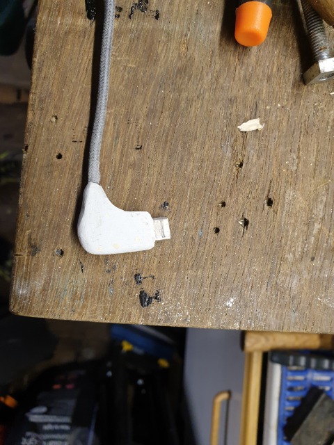

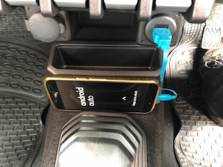

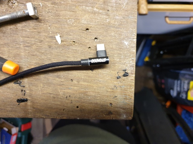

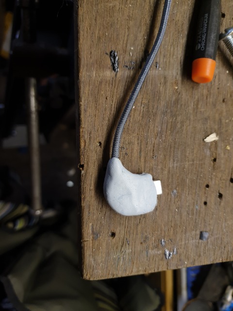

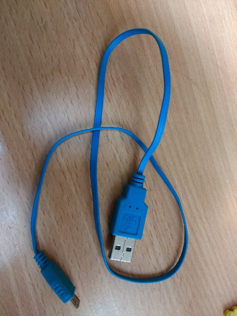

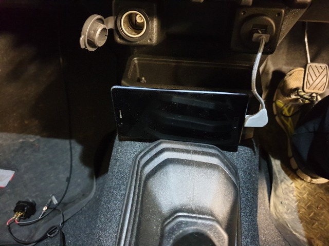

Not really something I did on the Jimny, but for the Jimny.
A while back I bought a 90⁰ USBC lead to use with the Android Auto. I have a magnetic mount on the front of the coin tray to hold my phone whilst connected. A straight lead stuck out too much. Unfortunately the 90⁰ lead only works as a charging cable an not a Data cable.
I had a short lead that was the perfect length, so I cut away all the plastic, bent the lead to 90⁰ as tight as possible and moulded some epoxy filler round it. Once set I filed and shaped it to suit.
