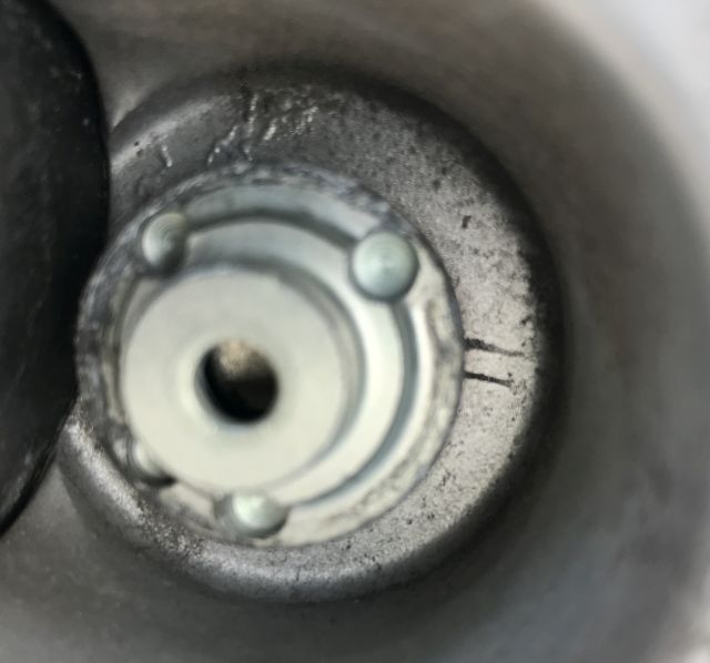

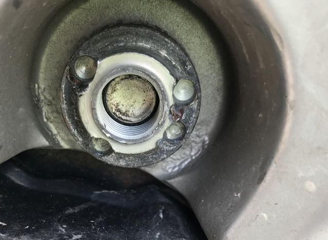

Was supposed to change front pads after seeing excellent wiki on here, but.
Unable to get wheels off as the locking nuts are solid and now have snapped heads. see pics
Been on since tyre upgrade in October and I jus cant budge them at all now as the key wont bite.
Will have to wait until Monday now when bro in law garage open and let him sort it.
Just glad not had a puncture during the winter I would have struggled to change wheel.
