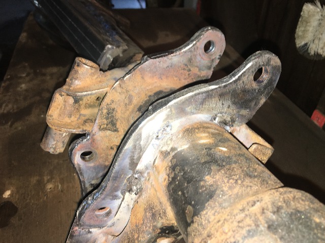

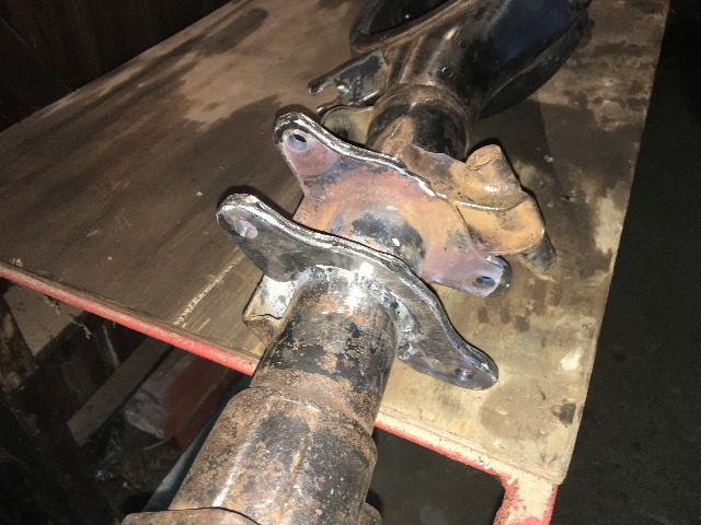

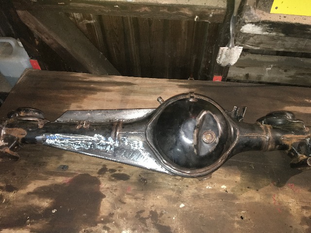

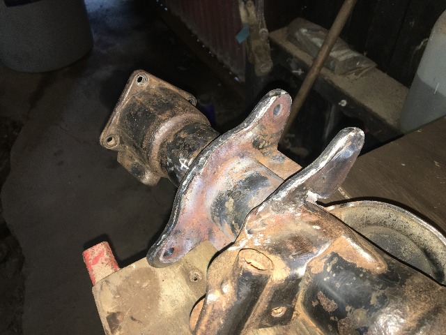

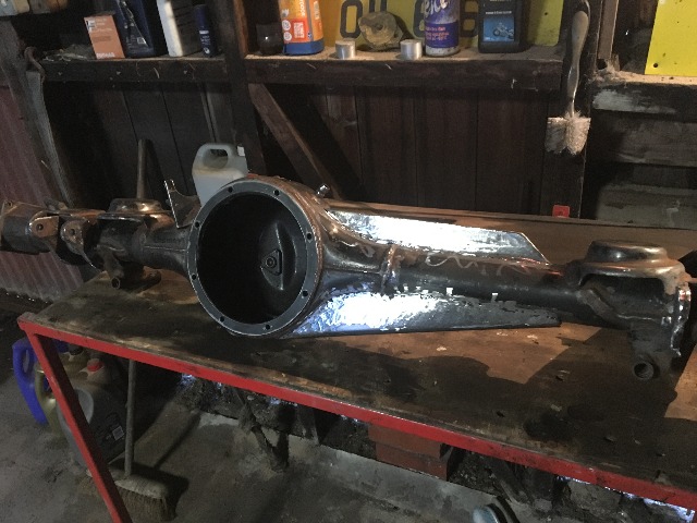

Replied by Riccy on topic What did you do to your jimny today

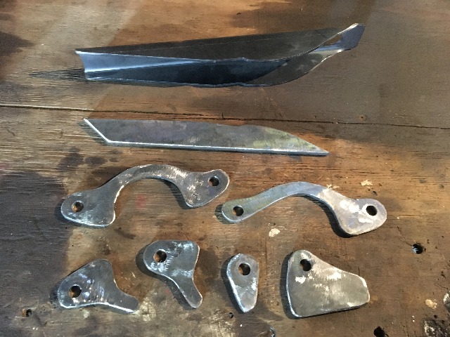

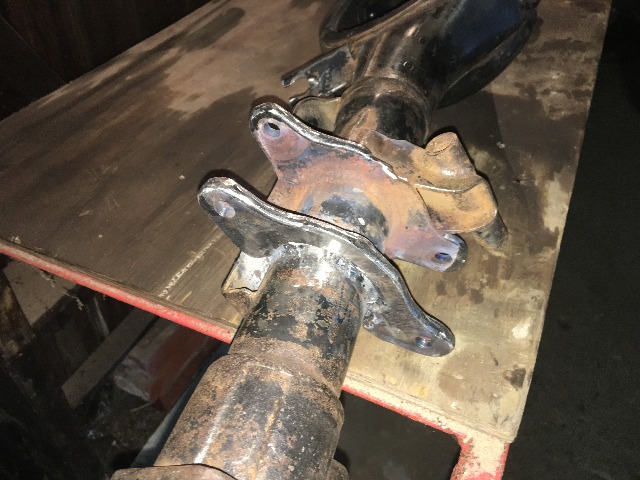

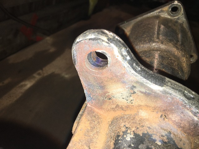

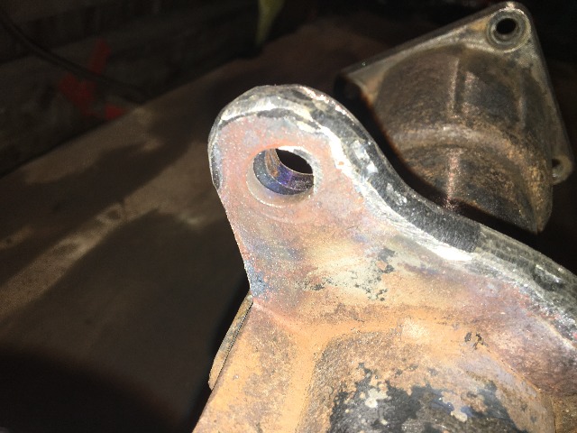

Bracing up the back axle...
I have removed the diff guard and gone for the gusset to weld on instead. While its off and stripped down I noticed the holes for the arms are going oval. So the solution was to make some plates for either side of the bracket to strengthen and brace them a bit. 6mm plate should be strong enough :laugh:
Also made a brace for the top of the axle out of 8mm plate.
Lots of welding and grinding (because my welding looks like it was done by Stevie Wonder)...
