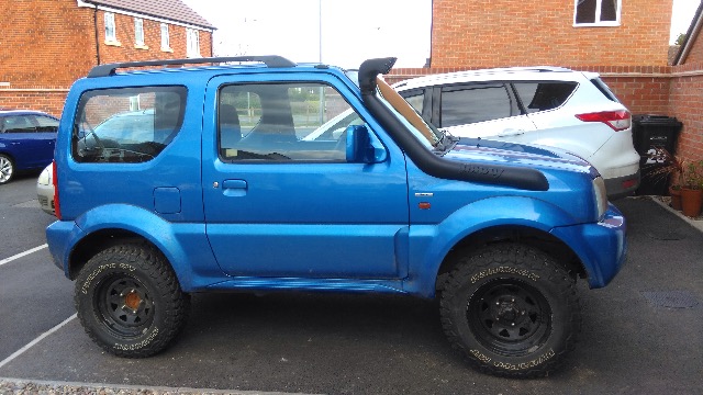

Saturday: Picked up the Jimny from the garage after having the following fitted: 2" Black Raptor lift kit, castor correction bushes and steering damper.
Have found no great difference in the driving manners of the Jimny after the lift kit has been fitted and no catching on the arches with the 0 offset wheels and 215/75 r15 Hankook MTs so all is good.

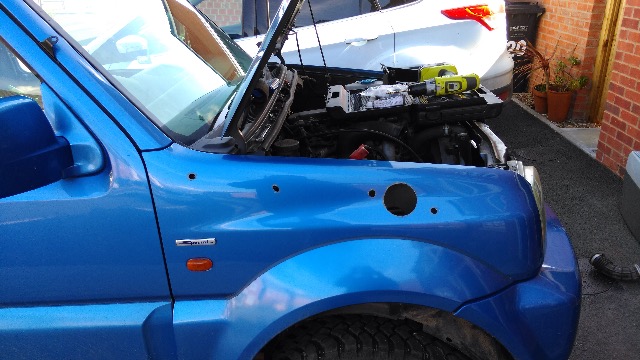

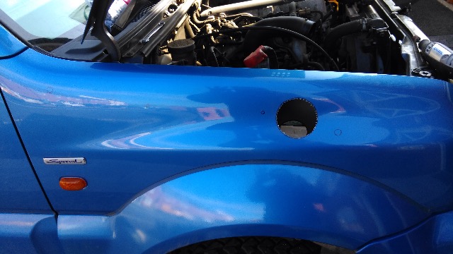

Sunday: Finally fitted my Snorkel - little disappointed with the poor fit of the "Template" but managed to fettle things to make it fit neatly, mainly the one bolt hole which had to be extended to fit the fixing stud. Sealed airbox drain hole too, nearly forgot but spotted at the last minute :laugh: :laugh:
Pictures of snorkel install:
Took it for quick test and found I now have the most awesome induction roar at about 2000rpm upwards, even got a few looks from the locals when setting off from traffic lights :woohoo: :laugh: :laugh:

Hey Eskimo thats a great read; made me grin from ear to ear that last bit.
Good to see the pictures of your steed; at least I will know what vehicle to look out for now!

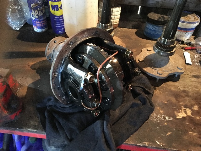

Repairs day following an excellent outing to North Wales with Dave, Brett & co... (Blog to follow from Dave as usual)
Had to get a lift home on the back of a transporter courtesy of recovery (long winded and very late so I wont name names here). Bad noises on the motorway on the way home so pulled over and had a poke around. Took rear brakes apart (ok), took rear prop off and ran 2wd (still bad). Wheel bearings most likley.
Rear axle removed and stripped down. Diff checks out ok. Locker working and just a little bit of backlash adjustment needed.
Culprit is the wheel bearings as suspected. collapsed somewhere on the race. Spares to order from Martin then...
