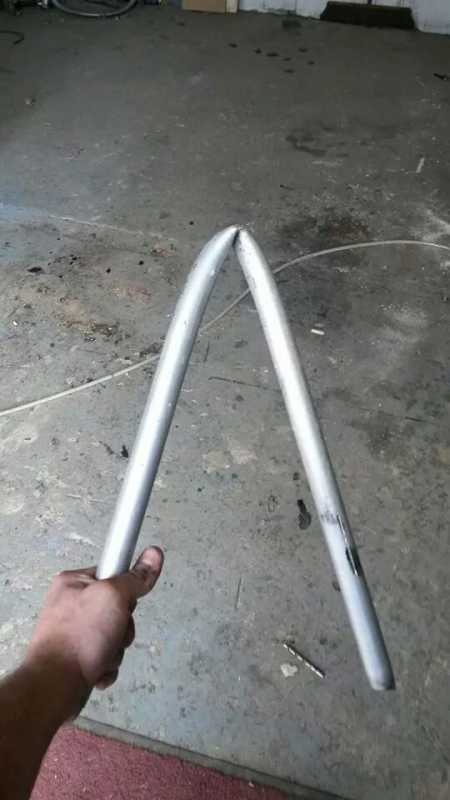

idiotmobil wrote: Is that a standered panhard if so I plead with you to not make a adjustable one fron a standered on they are so week it needs to be upgraded I bent my old one with just my hands and they have been known to give out on roundabouts etc and your roll over. Just will be a bit of waste of money for you not to buy some 25mm cds tube and weld the old ends on and have some proper ones if thats what you have done then scrap yhis whole comment lol
I agree.. looks like you have butt-welded your threaded sections onto the end of the tube also.. take a look at any of the Heavy duty aftermarket ones and they all have an insert that goes inside the tubing which clearly provides more support.. I'd be reluctant to take this on the road being honest because you have weakened an already weak part. good idea though:)
+1 any reasonably strong bloke can bend a stock panhard by hand!!

25 Apr 2014 08:00 #113270 by idiotmobil
Yep very week ive just made uprated obes and went abit overkill with 25mm 3mm wall cds I tryed bending one by juming up and down on it theres no chance but the old one well see these pic and this is just by hand
