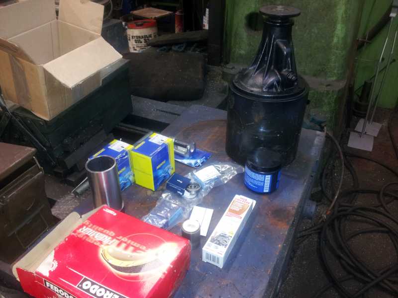

Started to fit my new cv joints from RSmanufacturing tonight,
Fair size difference
- idiotmobil
23 Jan 2014 22:22 #101773
by idiotmobil
Replied by idiotmobil on topic Re:What did you do to your jimny today
how much did they cost for both sides delivered they look nice and after doing both of mine in I should be looking at upgrading
- TomDK
23 Jan 2014 22:37 #101779
by TomDK
Replied by TomDK on topic Re:What did you do to your jimny today
I would like to know the price as well
And do the shafts fit the standard front diff, or does it require new gears in the diff? Is it side gears, they're called?
- lindsay
23 Jan 2014 22:44 #101782
by lindsay
Replied by lindsay on topic Re:What did you do to your jimny today
they were £525 deliverd ,
I had to change the side gears with ones off a rear diff,
ive got the diff done tonight and looking to finnish it at the weekend,
cant wait to try them out
