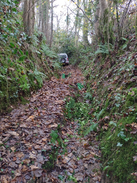

A friend found a new lane that's fairly local so we had to give it a whirl. I scouted it out a few days back and saw the top was impassable but there was enough room to turn just before it got really tight. The photo doesn't do it justice at all. The lane is steep with some deep washouts and rock steps. With lockers and sand ladders in a few places the Jimny crawled up it without any major dramas. My friend managed it in his Terios which has no low range or lockers. He's a very experienced driver and that Terios is surprisingly capable. In total it probably took us getting on for an hour to get up and back down the 0.5 mile lane. I'm tempted to give it a try in the trials car. I think I have a pretty decent chance of getting up. The trials car may be only 2wd and on road tyres but it takes a lot to stop it.

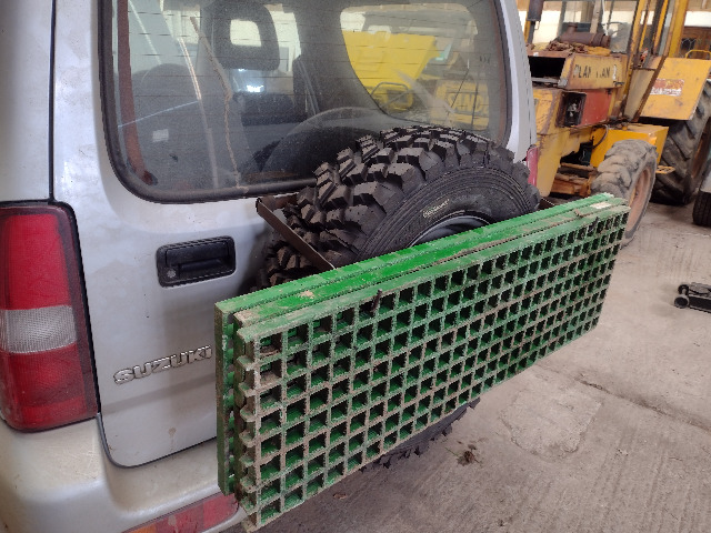

I am considering making a rack that can be clipped on the spare wheel for when we are going up tough lanes like this one. It just needs to have two hooks so the ladders can be quickly hooked on the back when they are not being used. They can be stored on the roof between lanes.

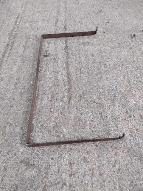

The rear sand ladder rack turned out to be really simple. It's just a piece of 25x3mm strip bent into a U shape with a couple of hooks welded on the ends. It simply drops over the spare wheel. When in place it's surprisingly solid. If you shake the car violently enough to shake one of the sand ladders off, losing a sand ladder is going to be the least of your worries. The only issue is security. It's really easy to remove them (that's the point) so it's also easy for someone to steal them.
