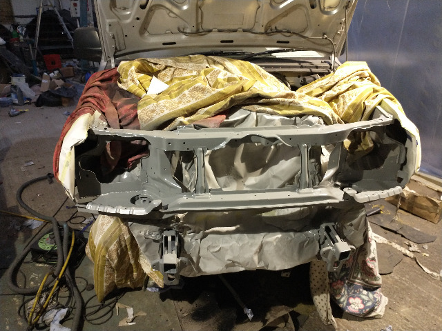

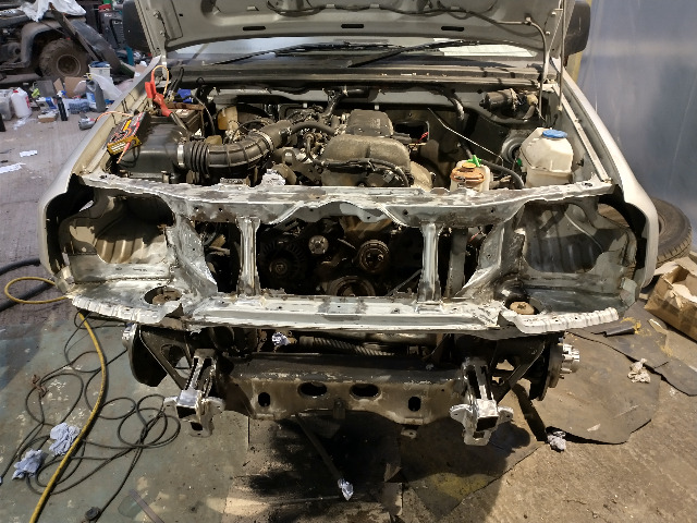

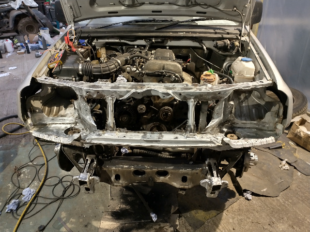

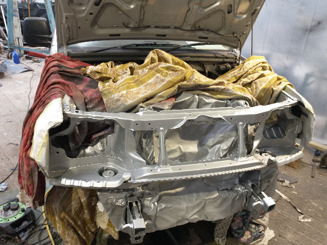

The end is nigh! I just need to repaint the front, spray more waxoyl and and put everything back together. It's nice to see it finally off the ramp after 2 months. I moved it to the 'spray shop' (basically a tent made from 2x4 wood and plastic sheet with a big fan blowing outside).

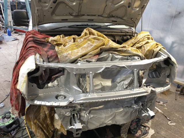

Many roloc discs later and all of the rusty paint is removed and all surfaces sanded ready for primer. I'm not going for a show finish here. I just want a uniform colour without rust bubbles.
2K epoxy primer on and drying. This stuff covers a multitude of sins. I may just have enough time for at least one colour coat later this evening.

Base and clear applied. Not the best spray job I've ever done but it does the job. I ony had just enough 2K clear. You know it's tight when you end up washing the last traces out of the cans with thinner to make sure you get all of it. This was left over from a previous project and when I checked a few days ago the cans they felt like they had more in them than they actually did. As it turns out I ran out pretty much as I finished the last coat!

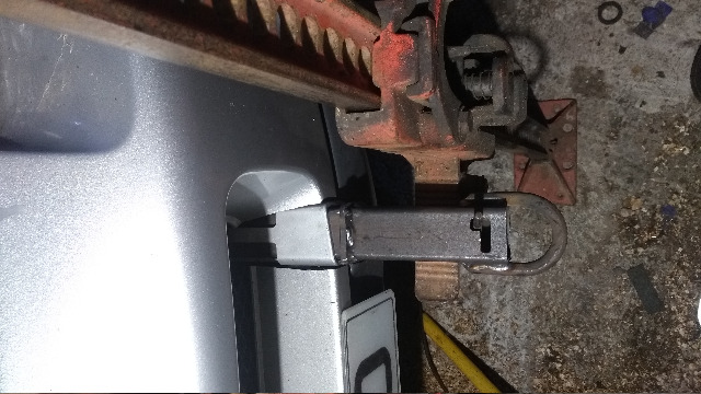

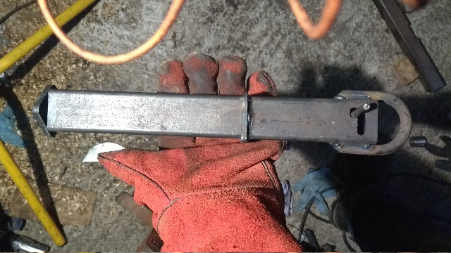

First the good news - the jacking/towing insert idea works. It even looks fairly close to my cad drawing.
Here it is installed on the front.
Now for the bad news - I took it for a bit of a test drive and there was a lot of bearing noise from the rear diff. When I installed the locker I cut corners by leaving the pinion alone. It turns out the large pinion bearing is toast. I don't know why I didn't notice the bearing noise on test drive when I bought it. Hopefully the new bearings, seal and crush tube will be in sometime this week. Lesson learned - when fitting lockers don't half ass the job. I did the same on the front but that diff has had very little use and it sounds good so it should be fine.
