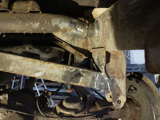

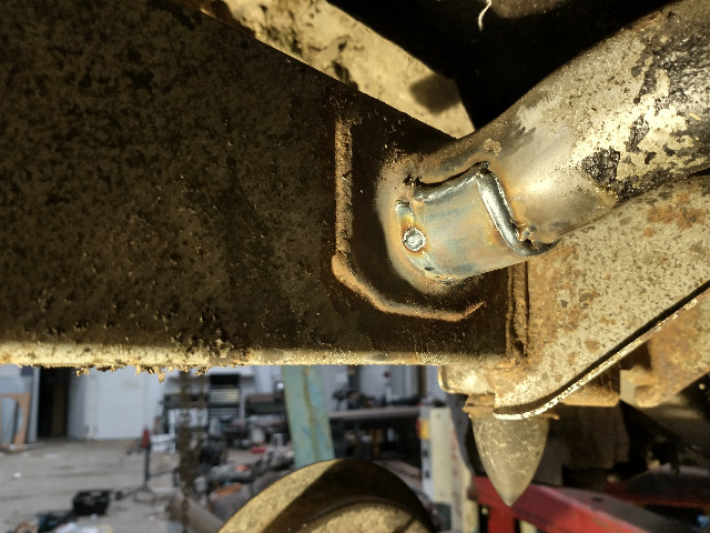

Got a bit more work done this afternoon. The only thing I could do with the right hand side of the rear crossmember was to cut out the worst of the rot then drive in a chunk of pipe that fits inside the original pipe. It's welded both sides of the chassis. The rot in the panhard rod brace is also fixed and the stupid gap above the brace filled in. For some reason the driver's side of this truck has significantly more corrosion than the passenger's side. Normally it's the other way round.
The left hand side of the crossmember is just patched.
I pointed the needle gun of doom at the upper spring mounts and to my surprise they are solid with no welding needed. The only other chassis welding was a small hole in one front outrigger. As far as I can tell the chassis welding is done. Unfortunately the previous owner sprayed the chassis with stone chip, which lives up to it's name. It chips as soon as a stone hits it. I spent a pleasant few hours needle gunning it off. When the time comes I'll be using schutz to replace it. That stuff just smears if you hit it hard.
While it's up in the air I need to look at some way of protecting for the transfer case without compromising ground clearance too much. I'm thinking a tubular frame as I don't like the way flat plates collect mud.
Last edit: 10 Sep 2021 18:46 by LesNewell.
